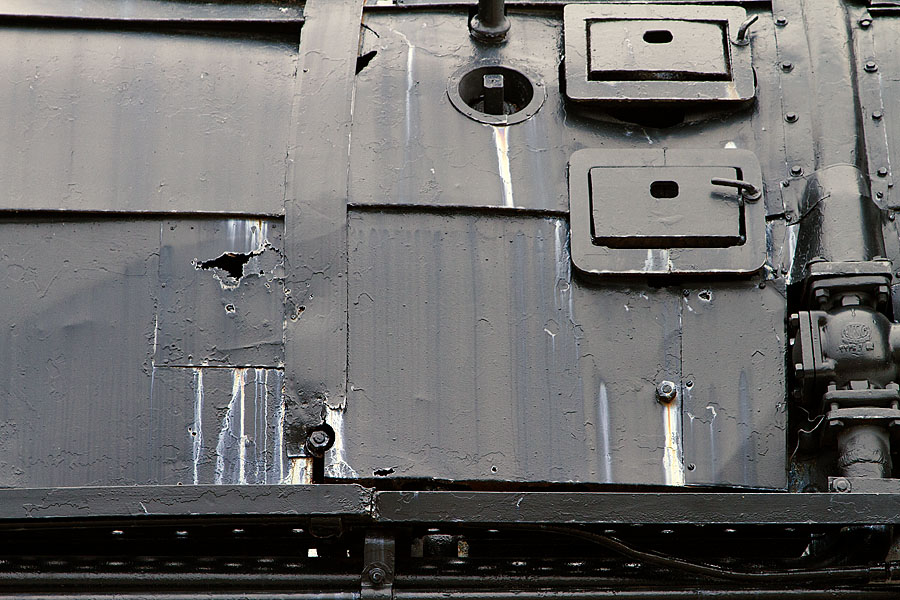

The streaks are the result or rust from something above.

Is that boiler and piping still lagged or was it removed and the jacket reapplied over blocks?
Steve
 Post subject: Re: Steamtown's UP #4012 Big Boy: Raindrops keep falling on
PostPosted: Sat Mar 05, 2011 4:48 pm
Posts: 528
Location: New Jersey, Central
I think 4012 still has it's lagging which is asbestos.
PostPosted: Sun Mar 06, 2011 12:30 pm
Posts: 1352
Location: Chicago USA
Great...water logged lagging eating away at everything.

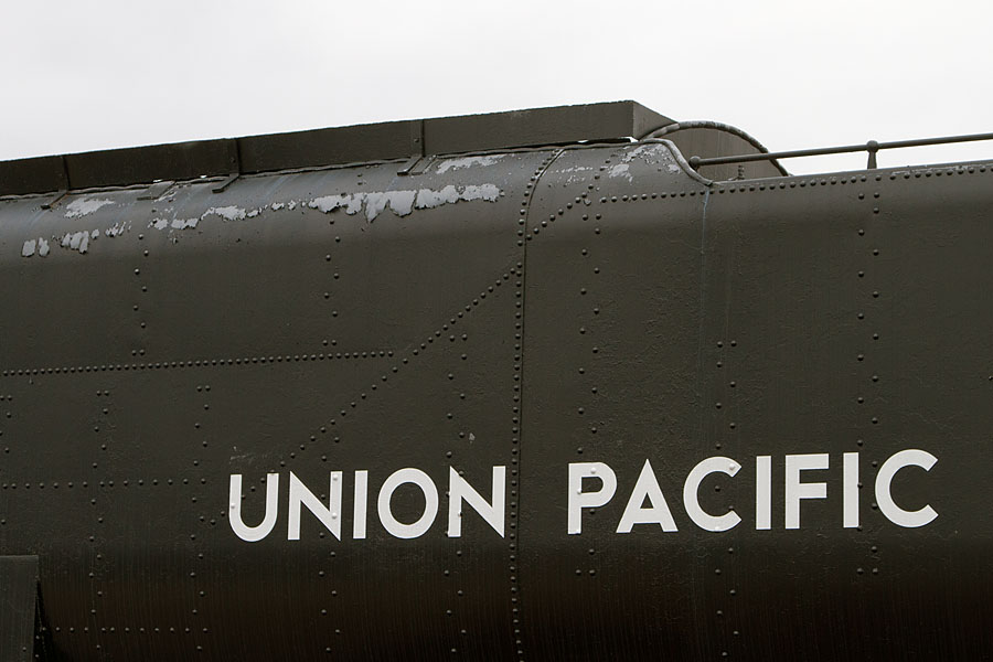

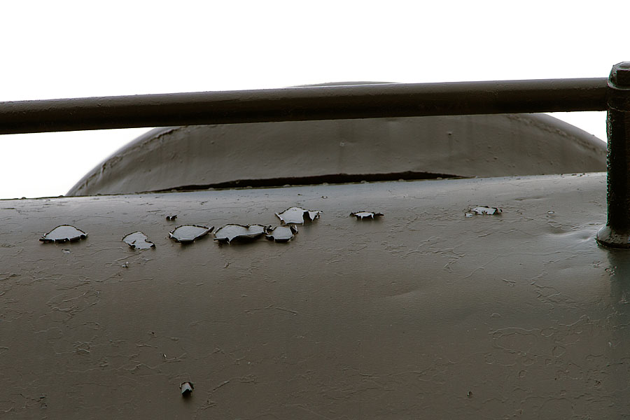

 Post subject: It's been 6 years (already?!?!) - Scranton, we have a proble
PostPosted: Wed Nov 28, 2012 9:10 pm
Posts: 596
Seems like Steamtown's UP Big Boy #4012 was just painted and quite a few of the locomotives that followed are just now making their way back on to display.
Just in time to start all over again?
True - it's not "preserved" until it's parked inside but should we have expected (hoped.. demanded) more then 6 years on a paint job? Was this a poor paint job or does it simply fall into an expected life span for painted equipment left outdoors?
Was there a practical method to upkeep the paint to make it last longer?
Washings of some sort - touch ups - removal of grease and oil prior to painting, ect?
Maybe it's not too late? We know how long these engines sat faded and rusting away and the paint only came after the government pitched an ill-fated experiment to simply print "extra" money. I don't believe we'll see much "extra" money in the next decade or so...

The locomotive was repainted during the first half of 2009. That is three years ago. A good coating system engineered to withstand the acidic atmosphere of the northeast would still be providing good results for several more years at least. The photo of the tender shows what appears to be a black topcoat applied directly over a previous topcoat. Now anyone who has spent any time painting metalwork knows that topcoats don't adhere very well to previous topcoats. Why was a primer not applied first? I would be curious to know what kind of paint they used. They may have used a water based DTM coating which is very picky as to what surface it will stick to.

Considering what the NPS likely paid for the painting to be done, I'd say we as taxpayers have a right to complain. In fact Steamtown management should be having the contractor back for remediation. Unless there was absolutely NO prep work written into the specifications, I'd say the quick failure of the top coat is evidence that the prep wasn't done.

Some background on the 4012 without getting into the "hot button" stuff.
The 4012, along with a handful of other pieces, was repainted prior to the asbestos abatement project at Steamtown. If I recall, the NPS had problems with one of the painting contractors they had gone through at the time. I'm actually thinking the company went bankrupt or disappeared during the job?
The "stimulus" money went to removing the asbestos in a number of locomotives (and cars) as well as re-jacketing when finished. All done by Gary Bensman and a very professional crew. This included the Grand Trunk 6069, NKP 759 and Reading 2124. The 4000 was not included in this project. Final painting was done by Steamtown inside their shop in a more controlled environment. These pieces should hold up much better over time. Both the 6069 and 759 are now kept under cover in the roundhouse, the 2124 will not fit.
Steamtown does have a long range "wish list" for indoor storage, but it comes down to money, and we all know how that movie ends.
What you have with the UP unit is a well intentioned, if poorly executed, triage of a paint job.
