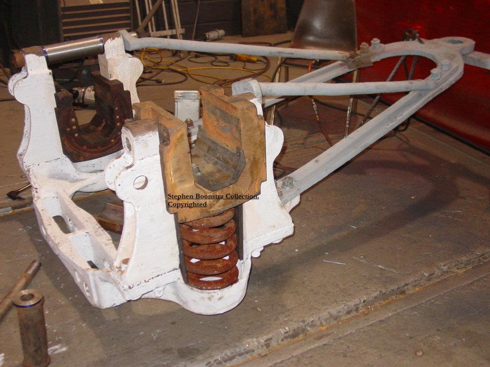

We are planning for the 20 Oct, Thurs, as a workday. Let me know if you can make it.
Planned for the day is:
Weld the cracked bracket on the radius arm
Cut and clean up slots on front springs
Start making brass insert for the Center pin. This will be installed into the frame.
Additionally, we are planning a weekend workday sometime in Nov. It's looking like the 19th. More to follow.
Thanks.

Ok folks, I'm planning a workday on 22 Dec and 29 Dec for working on 565. If you can help out let me know. Thanks!

Well this year we saw plenty of work and parts made for the 565.
We installed the smokebox cover and some of the internal parts for the smokebox.
Bolted up the steam pipes
Removed the wood from the cab. Cab report is under way.
The pilot truck installation was a goal for us but we fell short due to some unexpected parts needing to be made/repaired. We are close.
--Modified both journal boxes to fit.
--Welding is under way for the cracked radius arm.
--Crosstie on the frame for the connection of the radius arm has been refinished and bottom plate is made and just needs final sizing and welding.
--Dan Barrett's High School completed all the parts needed for the pilot truck swivel point to be attached.
--Spring set for #1 driver are ready to be banded.
Still need:
Center pin to be made
Bushing for where the center pin goes thru the frame
Grease wells made for modified journal boxes
Made brass for the axle to ride on
