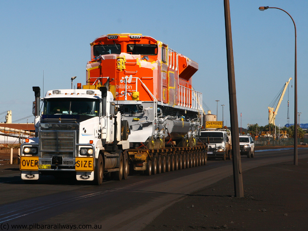

JasonB wrote:
Greetings all,
Or, let me phrase my question this way, what's the largest size locomotive (tonnage or size) that could reasonably be transported by truck?
Thanks, -Jason
Quite large as in this SD70ACE:
File comment: SD70ACE being hauled by truck in Austrailia!

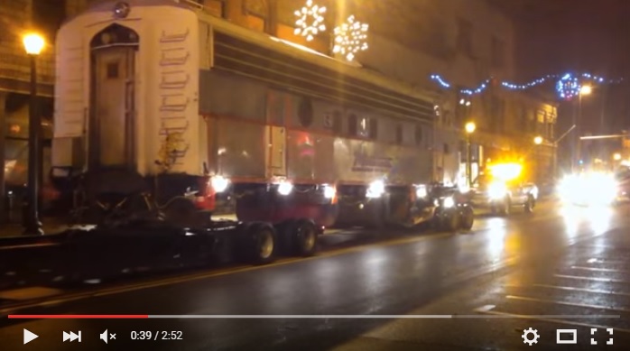

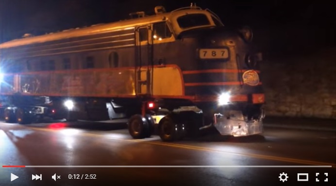

Two F7's in Minnesota were moved 10 months ago using fairly modest-looking dollies.
See images below. These little dollies make some of the enormous rigs used for other moves look like overkill. According to an old thread, the journey was 40 miles. Can anyone guess if a simple dolly-rig like this would be safe enough for freeway travel and a cross-state journey of several hundred miles? Intuition tells me no. But I wonder what other people have seen out there.
Another good Rypn thread: Moving a locomotive & a word of caution . Feel free to bump that thread if you have something to add to it. Thanks.
Image source: https://www.youtube.com/watch?v=m2Eokg3VF-w

Posts: 198
Makes me wonder if these were just gutted shells, the rigs look too light to be transporting them if they had their prime movers and electrical gear

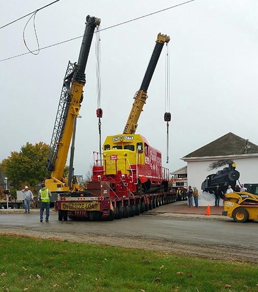

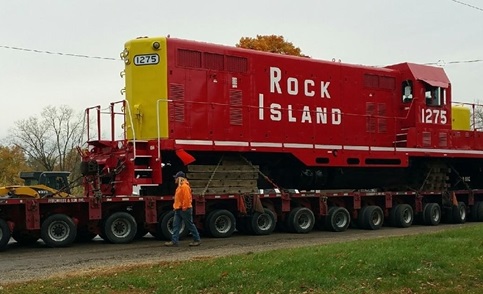

Contrasted with the Minnesota Zephyr F7 locos above that were moved on simple dollies, this Santa Fe diesel was moved this month on a huge centipede-like trailer.
Photos from Ottumwa Post:
http://www.ottumwaeveningpost.com/9470/ ... e-on-track
Off-topic: It's former BNSF 3822.
