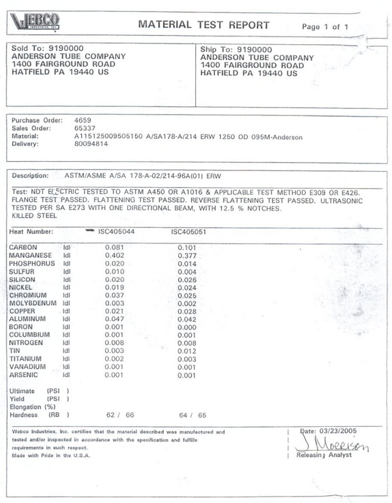

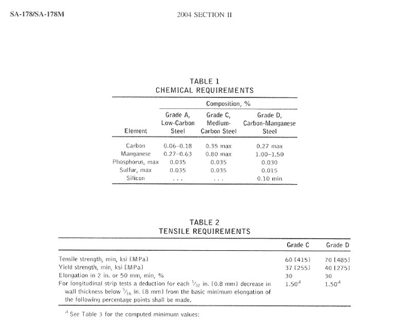

Bobk wrote:
Is it possible to see material reports for tube material and also and explanation of the report showing clean Vs dirty material and how one is more corrosion resistant than the other?
Short answer is "nope".
Notice tensile and yield are not required for Gr. A & B.

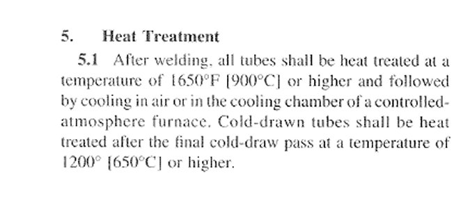

SA-178 is fully annealed after welding and again if cold drawn to finished size. Should be pretty stress free internally.
