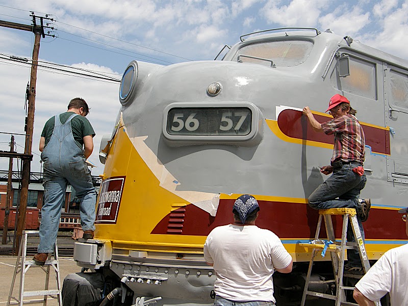

A photo of yesterday's progress. Continued masking of the flanks, plus the white letters covering the maroon. Later in the day they painted the black on the lower body.
Locomotive no. 57 is still being sanded and prepared for paint in the roundhouse.

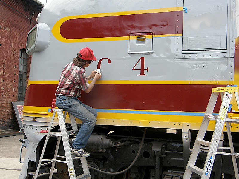

They are vinyl "paint mask" material. The photo shows it being pulled off for the numbers. This is the first time I have used this and it has worked very well.
The original EMD paper drawings were scanned and traced in a vector drawing program then exported as an Adobe Illustrator file which was then readable by the plotter/cutter that made the masks. By doing this method, the lettering is as exact as Mr. Dedek at EMD drew them in 1944.
In combination with the Dupont Centari paint this process has worked very well.
Rich

File comment: pulling off the vinyl mask from the road number after it was over sprayed with gray paint

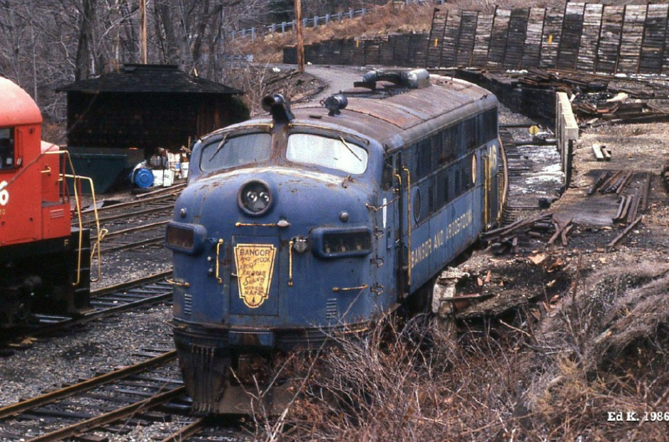

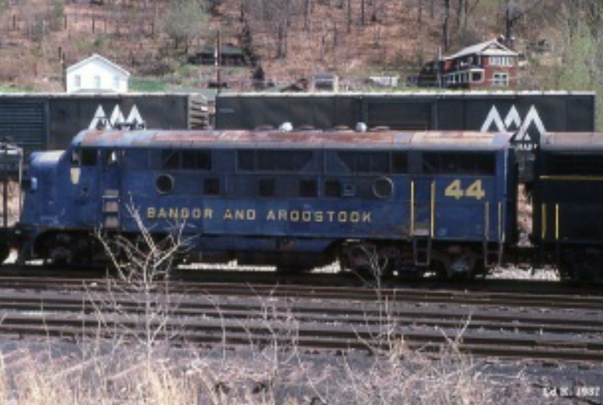

Thought you all might have a look at the F-3's when they first arrived here.
Ed K. cp Laurel Run

Nice ones, Ed. I also like the Vermont Railway boxcars in the background of the second photo. Who would have thought they might be historic someday?
