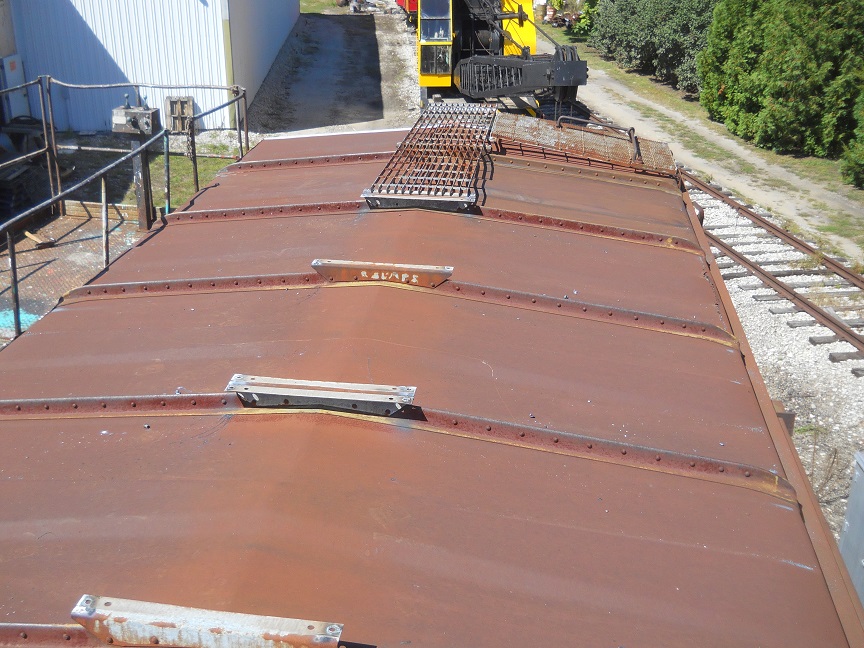

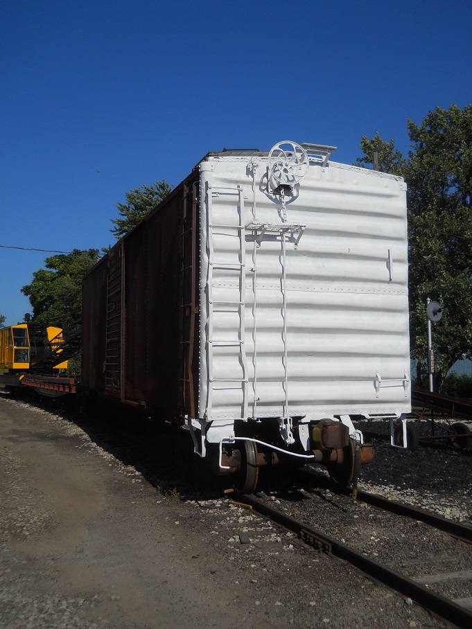

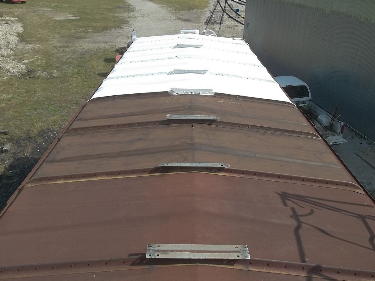

Recent work at HVRM on C&NW #284 is shown in these photos.
Mark needed the roof walks taken off so that he could clean the roof before he primes and then paints it. The first photo shows Bob Albert on 9/2/17, cutting the rivet heads off and punching out the balance of the rivet. Bob only finished removing about half of the walk that day.
The second photo was taken on 9/9 and shows that, as of the break for lunch, Bob had only the very end section to remove.
Mark WAS able to clean and prime both ends of the car and the results of the "B end" is shown in the 3rd photo.
Incidentally, there was a morning Board of Directors meeting at the museum on 9/9 and the question was raised as to whether the roof walks should be reinstalled on the car after it is painted, or just left off. The Board voted to reinstall them.

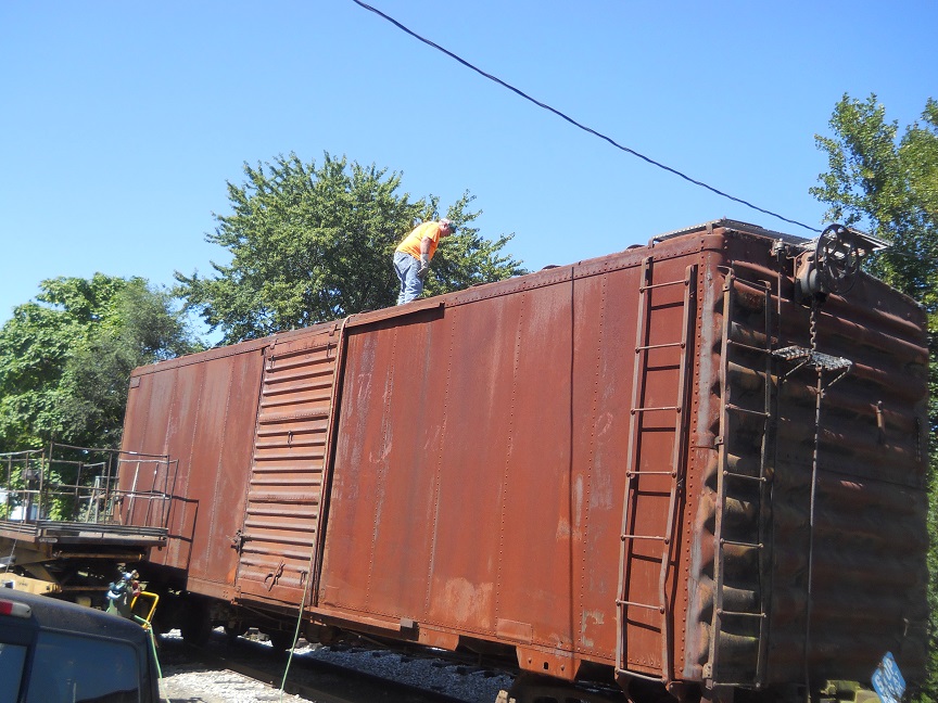

Received the attached photo from Mark today. Obviously he has spent this beautiful Sunday working on C&NW 284. He has cleaned and primed one end of the roof of the car. The man's on a mission!

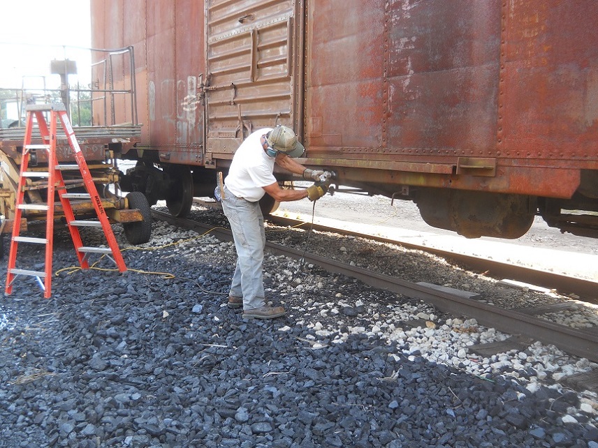

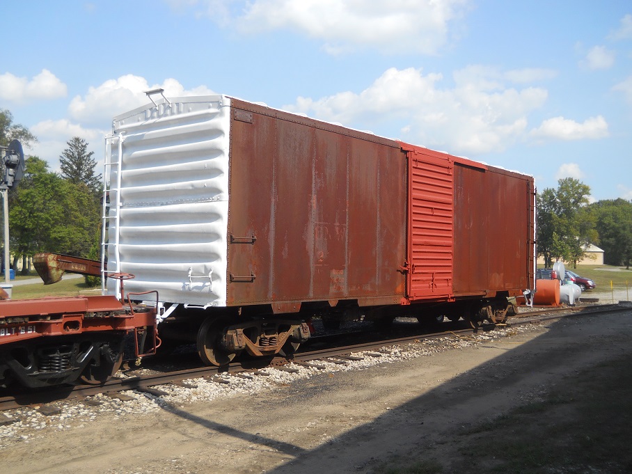

Update from this past Saturday. First photo shows Mark cleaning the door and surrounding area on one of the cars doors, while the second photo shows the door on the opposite side already done.
