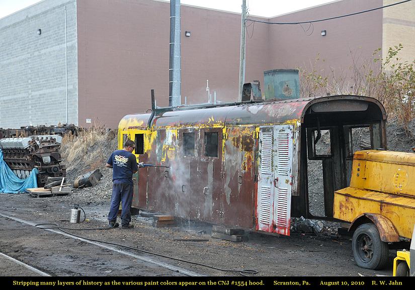

1554 has had the new engine and other parts installed and has been sucessfully test run this week without the hood in place. Meanwhile the hood is being prepared for a new coat of CNJ green paint.
File comment: The many colors of its past history are being removed.

Is he just power washing all the old paint off? The hood does look solid though with no major rust damage. This should be a sharp engine when done, don't know of too many CNJ engines left.
Now to just entice these guys to come up North a bit and redo the RS 3 in my avatar! ;)
