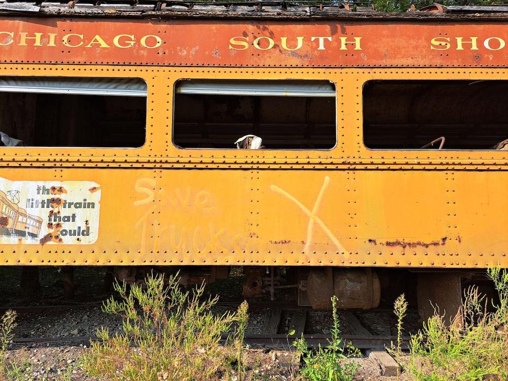

Necroposting, but CSS&SB cars #102 and #109 were scrapped at Boone, IA in the Fall of 2023. They are no longer extant, though a few components from each were salvaged before they were cut up.
The roofs and floors had rotted away to the point of nonexistence and they had already become immobile eyesores some years back after tarpaulins covering them disappeared.
The other CSS&SB cars at Boone are still extant, and #106 supposedly can run "slowly" under the overhead from what I was told.
