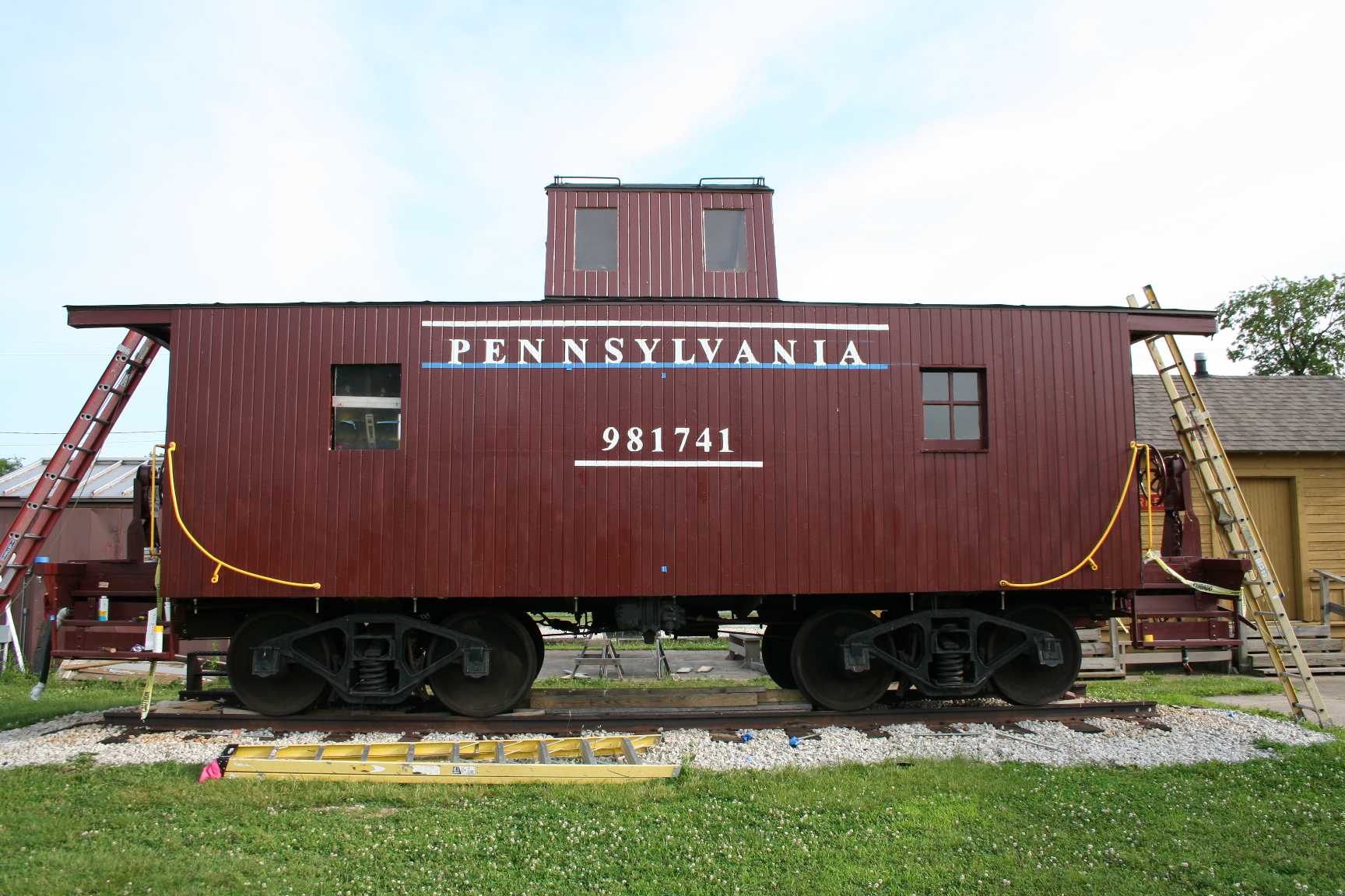

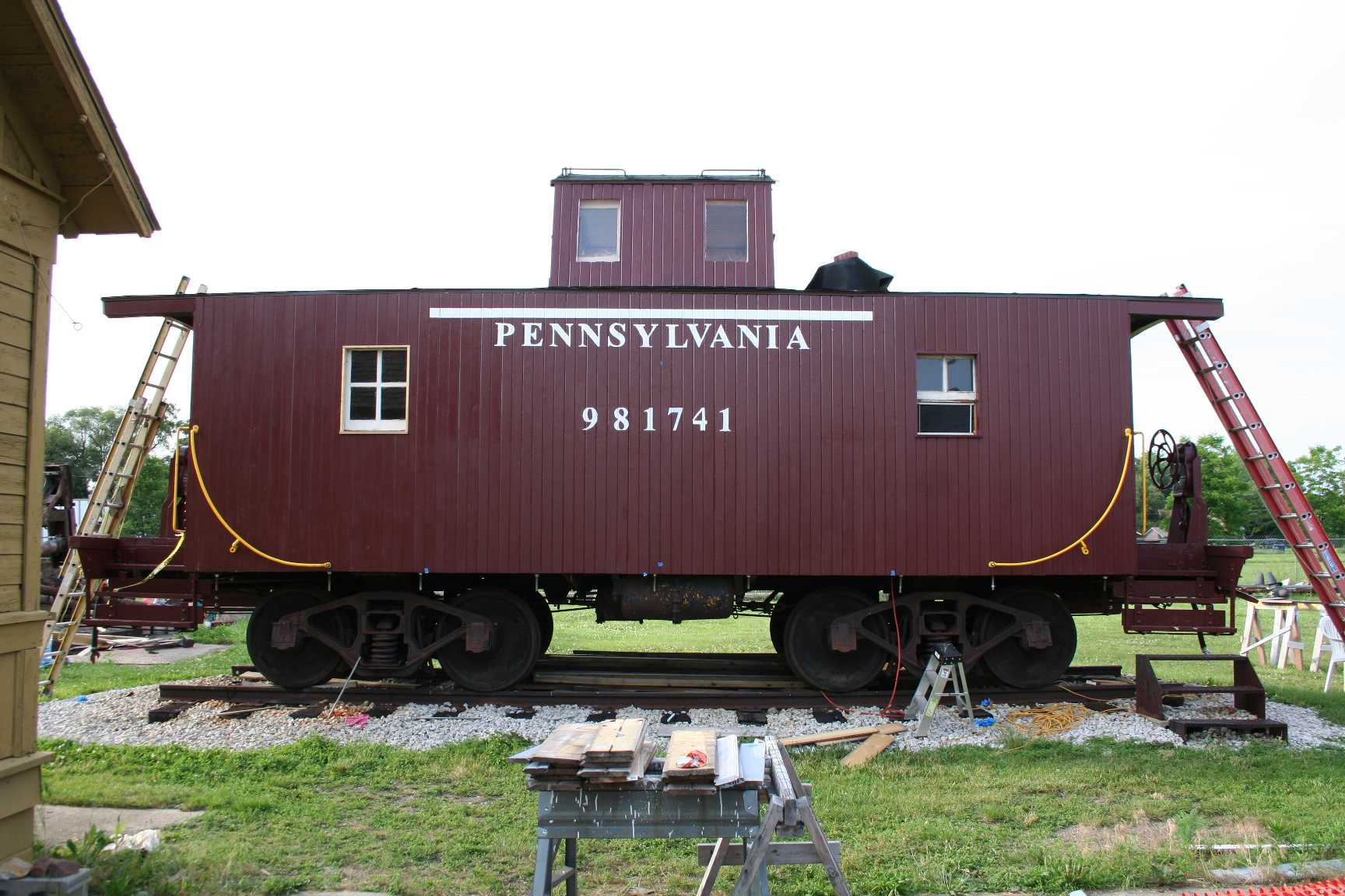

our project chairman has been tinkering with lettering ideas.
Bill

I'm assuming the lettering is just cutouts of white paper? The last photo has an "N" upside down. That number lettering looks like computer generated and not the correct PRR style.
Richard Wilkens

In that photo, it looks like it's being hand lettered (note the masking tape with over run)....the N is just incomplete yet.
The prior photo of the opposite side, shows completed lettering.

Oh, man! Now that is just sweet. Congratulations on a great accomplishment.

It is computer generated and the wrong font AND hand lettered. The idea is to try a couple of different layouts without the expense of stencils and then after we agree on the correct stuff have the correct stencils we want made...hence my term "tinkering".

Find yourself copies of The Keystone, December 73 & December 74. They contain great information on PRR cabins.
To save you some grief and expense, choose a lettering scheme from photographs or the Morning Sun PRR color guides, 3 volumes. Then decide which one your folks like and have vinyl stencils made to match the photograph.
While sometimes called font, it is my opinion that there is no font to exactly match the PRR lettering. The PRR lettering is more in the logo or herald world. While close to Times Roman and Craw Clarendon, to be a true font the letters would have to contain all the characters A-Z and numbers of a given size.
While some fonts are close they might not be exact and that is up to you and your organization and how many “rivets you want to count” with out pulling your hair out!
If you can also find a graphic artist schooled in the arts, he or she could hand draw and cut some of the stencils that a computer generated font cannot match.
You can also use computer generated fonts and just use extra vinyl stencil material to adjust or mask off the lettering as needed.
