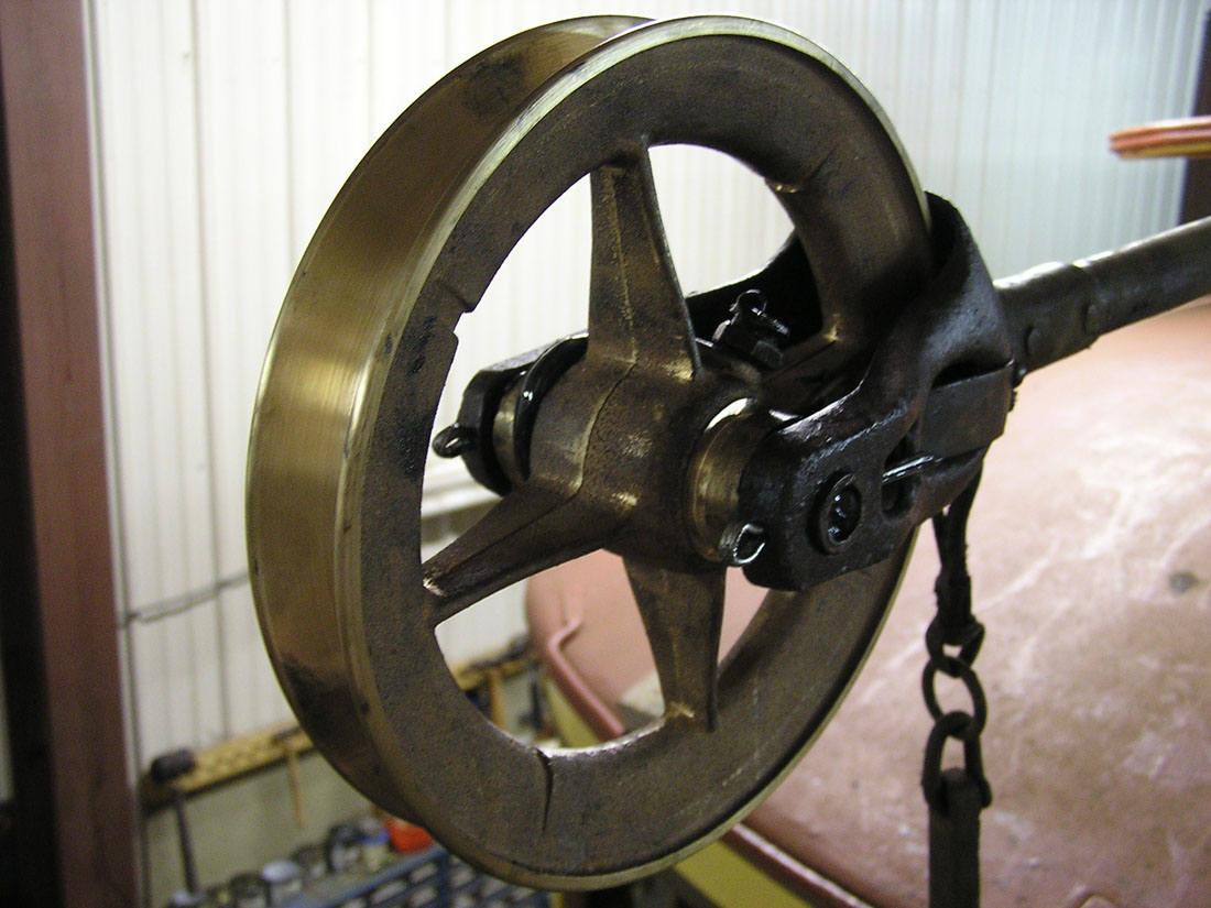

OK, I couldn't resist. This is for the fringe group who enjoys the minutia and the details that makes our avocation so fascinating. BTW, we cast and machine our own trolley wheels because they are of an odd size.
Here's a close-up of one of our TCRT trolley wheels. There's also a short article on trolley poles in Wikipedia. http://en.wikipedia.org/wiki/Trolley_pole
