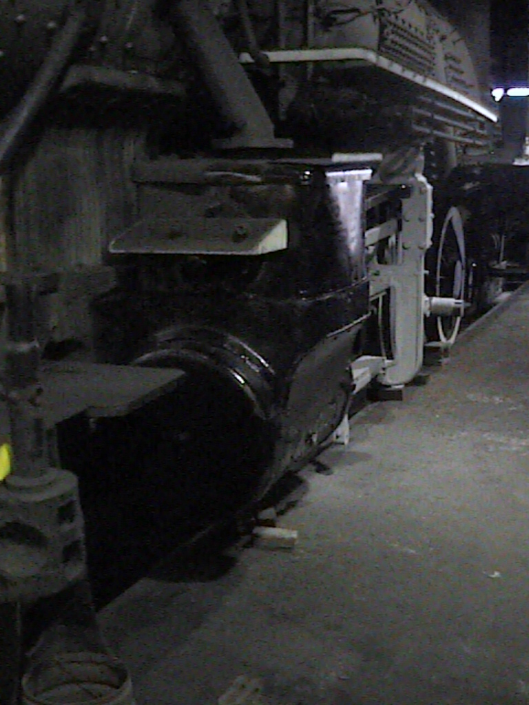

The primary question in my mind (and this goes back to my last point) is the cause of the sag. Lead trucks are usually intended to guide the engine around curves. They are not usually designed to be weight bearing. This engine appears to have its center of gravity pretty well lined up with the center driver. I am wondering if the "sag" toward the front is a problem in the driver springs and spring hangers, not the absence of the lead truck.
The reason for the sag is two+ fold. The springs and related equalizing hangers and bars are missing, and, the front driver journal boxes are not in place. There are only blocks of wood where the boxes are supposed to be. Another contributor is that the front pedestal binders are not applied. This is noticeably contributing to the front end drop as the toes are pinched in. The fact that the waste sheets are torch cut loose doesn't help matters to make the frame structure more ridged.

Seems like a good plan if you are trying to kink the frame. It was me, I'd have had jacks under the saddle first thing and made some sort of temporary binder to hold the jaws at the right opening. Just saying.........I recall the Strasburg guys solving kinks in a set of new flame cut frames using the surgical application of heat at specific locations - maybe they can advise.

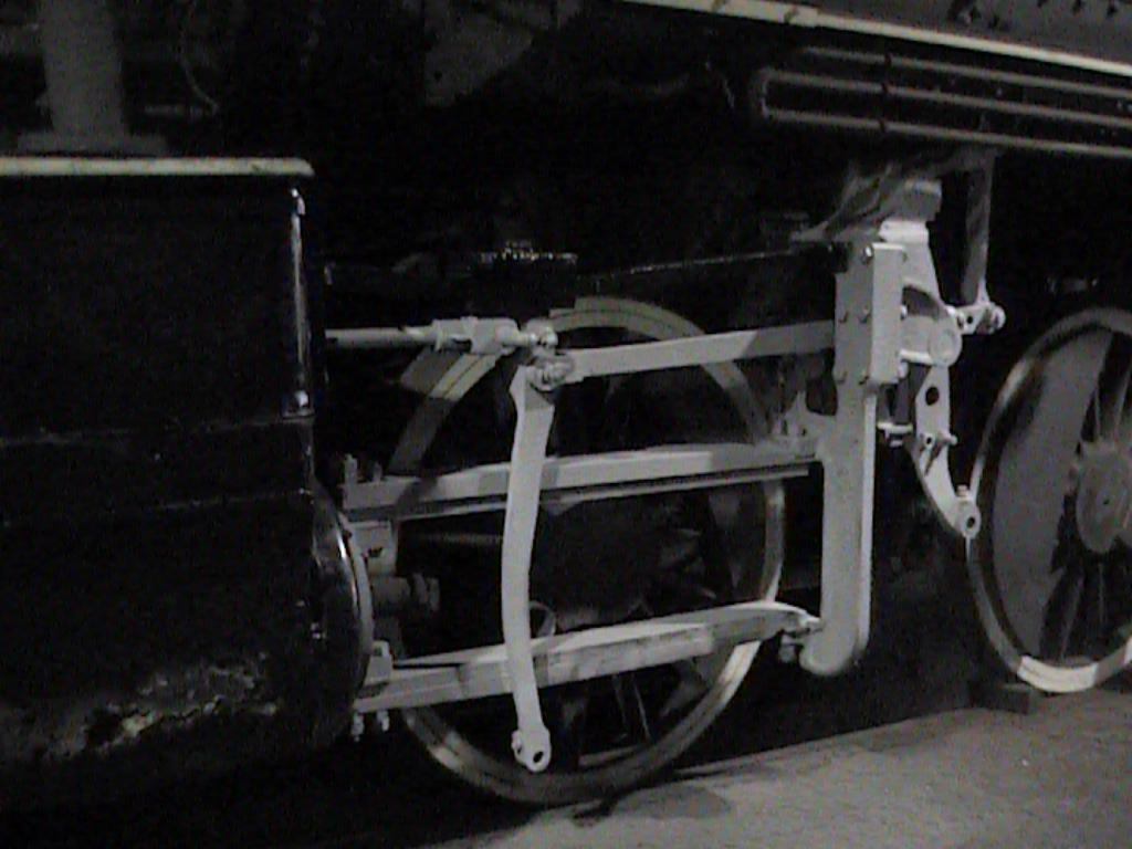

Dave that frame has been like that for 30 years. No journals installed. So when we jack her we have to do it very carefully. I'm going to treat it like when I have to install a stress panel on an aircraft. We will slowly jack her with the steel plates, that go under the journals, kind of lined up, then slowly raise her until the bolt holes line up. We will have to get the holes to align then go from there. We may be able to tell if the journal slots are kinked down by just measuring top and bottom for a difference.
The front driver is only resting on 4X4 blocks between the frame and the axle. So she is really nose down.

Hi all,
Well I 'm back. I had a great time up at Steamtown today. we got a few things done . Dan the man that came down from New York was a huge help! He worked on the Left leg iron on the back of the tender and took it off. it needs to be fixed , through the years it got bent back some so , He took it off and some time soon it will get back to shape. the way the photos shows it should be. We saw the right one needs to be fixed too. So the next time that one will be removed also. I was working on sanding off rust and old paint up front on the locomotive where the cross heads go. then I primered the areas with light gray paint. that's the only color I could find. so it wouldn't rust up. I even touch up the gloss black on the piston housing sheet metal it looks better for now.
Here is a picture of it.
I'm planning a work day in July. I had a few replies for the date of the Sunday July 19th. so I'm hoping there will be more to show up to help.
I would like to get the tender over the the main loco shop to have the oil tank remove and start to restore that. And then worrie about 565 latter. when we have all the parts to put the lead truck back on.
The tender is will be a little easier then working with the loco. so it should get restore faster. I think once the tender is looking like it's old self, I feel more people will come out because they'll see we are not fooling around. I'll have a video up on youtube soon of the updates on this project.
Take care all.
Len.

565 front view looking back.
A note to Bruce. could you please put my water bottle in the cab. I for got it. it's on the running board.
Thanks.
Len.
