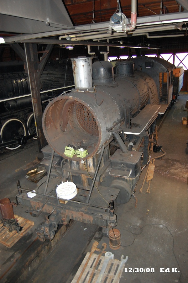

A look at 565 as of December 2008.
Ed K. cp Laurel Run
File comment: 565
Ed K.
