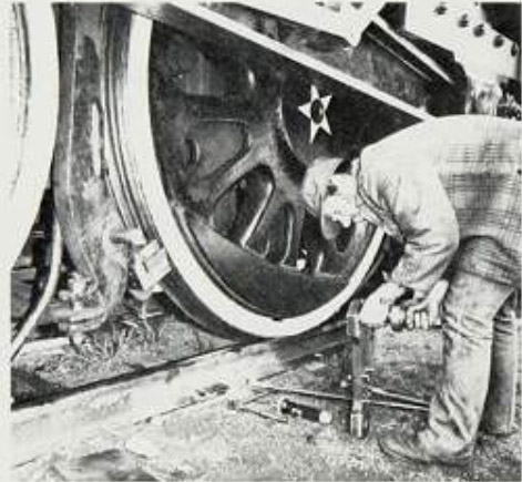

I hope Kalmbach doesn't mind me quoting a photo caption. The photo credit itself belongs to UP, which no longer runs steam locomotives. (!)
From TRAINS December 1975.
SIDETRACKED by an ICC inspector for a "condemnable flange," American Freedom Train No. 4449 relinquished her job to diesels in late September [1975]. A Lidgerwood tool attached to driver brake beams trimmed 3/4 inch of metal off her flanges while she was parked in Omaha Union Station. On Sunday, October 12, the ex-SP GS-4 was declared fit and was ferried west to Cheyenne in company of Union Pacific's recently overhauled 4-8-4 8444.

[quote="filmteknik"]I hope Kalmbach doesn't mind me quoting a photo caption. The photo credit itself belongs to UP, which no longer runs steam locomotives. (!)
From [b]TRAINS[/b] December 1975.
[i]SIDETRACKED by an ICC inspector for a "condemnable flange," American Freedom Train No. 4449 relinquished her job to diesels in late September [1975]. A Lidgerwood tool attached to driver brake beams trimmed 3/4 inch of metal off her flanges while she was parked in Omaha Union Station. On Sunday, October 12, the ex-SP GS-4 was declared fit and was ferried west to Cheyenne in company of Union Pacific's recently overhauled 4-8-4 8444.
[/i][/quote]
Further info if anyone is interested. I was a senior at Des Moines Tech High School studying machine shop. The device used to profile the drivers as not an actual Lidgerwood. A friend of mine designed a device like a Lidgerwood to do the job. His name was Dave Peterson. I got to participate for some time while skipping school. Dad was furious. Mom said it was educational and I may never have the opportunity like that again.
Anyway, they tried to drag 4449 with a tow truck thinking it could be done at a slow speed. The stretch in the steel cable was an eye opener. 4449 would start moving slow until the cable got really stretched. Then would take off like a rocket while the shavings would come off red hot. Then 4449 would slow down again as the cable would un-stretch. This continued on for a short period of time until the cable snapped near the locomotive. And I watched as this steel cable ball came rolling and hurtling back to the tow truck as the operator was diving out of the way. Quite a sight. And hilarious looking back. But not at the time.
They sent the tow truck packing and got a switcher. I'm thinking it had a "hump" speed. But I could be wrong. Memory you know.
I still have the prints that Dave drew to manufacture the "Lidgerwoood" copies.
Dale Grice
