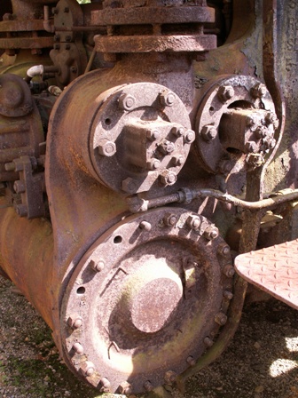

"It's not the "normal" Franklin Type B rotary cam poppet valves."
Hugh, you're absolutely right.
Even still, the patents are not going to tell you that the nominal rod length should be 30.523" for intake and 38.340" exhaust -
Read the angle of both cam shaft arms toward the other end of the cylinder by revolving the main driver. Intake should swing 20 deg. 15 min. at back dead center and exhaust should swing 19 deg. 45 min. at the same time.
Those are generic specs for the "OC" system and may be totally out to lunch for a specific application.
I, too, would love to see 611 run again. Wouldn't that be cool? That's why I spent so much time trying to help uncover "the lost scrolls".

Fortunately for this setup, you've only got one camshaft that drives all the valves. You might have to do it via trial-and-error, but with the engine in forward gear and one cylinder at Top Dead Center, it seems like it'd be obvious how to "time" the camshaft so the admission valve on the appropriate cylinder is fully open at or shortly after TDC.

I think it's safe to say that none of the Franklin equipped engines used a conventional power reverser.
For this particular engine, the reverser consisted of a 3 position control valve in the cab that supplied compressed air to a piston at either end of the camshaft. When air was admitted, it shifted the cam sideways fully to one side or the other of the cylinder block. One position provided forward running and the other provided reverse running. The unique cam profiles effectively provided changing cutoff as the engine sped up without any additional adjustment of the camshaft position.
For other Franklin rotary cam equipped engines (none of those remain unforatunately), a shaft turned a pinion gear that shifted a rack that moved the cam shaft from side to side. The camshaft had multiple sets of cam profiles that engaged the followers that lifted the valves off their seats. The engineer moved the cam with a wheel in the cab; I'd imagine that had power assist.
For the oscillating cam valves (Type A), the enclosed valve gear supposedly consisted of mniaturized sets of Walscherts; I'm not sure how it was adjusted.
(edit) One of the patents linked on the previous page: http://www.google.com/patents/US2234613 confirms that the Franklin Type A valve gear "box" contained miniaturized sets of Walschaerts valve gear, and this gear does appear to use a conventional power reverse, at least in one of the "embodiments". The locomotive in the patent drawing appears to be a Pennsy K4, so I'd guess this was the gear arrangement that wound up on K4 #5399.
