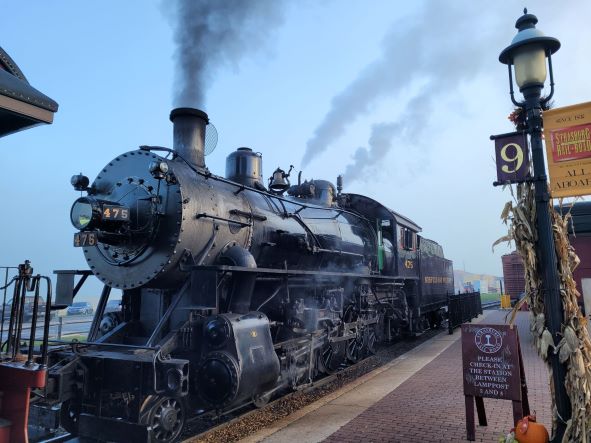

Photo of our beloved 475 as she returns to service early this morning. Many thanks you those of you that supported us the last couple of days.

#475 returned to service early this morning to power a chartered film train followed by our regular excursions. Fortunately, the damage to the hardware inside the smokebox was very slight, confined to some of the cinder netting and the framework that holds it in place. The greatest tragedy was the headlight that was demolished.
Immediately following the accident, we began to compile drawings and order materials for replacement parts. I was actually on the phone from the site of the accident issuing instructions to place orders and move manpower resources around to get the locomotive back on the road. The smokebox front has been replaced with a steel disc. All other parts were repaired and reused in some way. The smokebox door was brazed back together over about a 12 hour period where the pieces were all reassembled. This didn't go perfectly because of the amount of braze material needed and the small size and number of pieces. Due to some warping, we decided to remove the original clamping flange from the door and attach the entire piece to a new steel ring that the dogs clamp against. We had to replace one stanchion for the grab iron machined from steel and we replaced the door hinges attached to the smokebox cover to ensure the door fit properly and swings freely. A replacement headlight was dug out of our storage and was completely rewired and some missing parts for the focusing mechanism were fabricated. The last of the parts were installed and the locomotive had a new fire lit by 2:00 PM on Sunday; just over 96 hours after the damage occurred.
