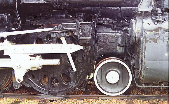

look cut to me..

Dave Lewandoski wrote:
look cut to me..
No closer than any of the videos were shot at - it is impossible to see that the piston operating rod has been severed.
look cut to me..
I hope you're not using that pic as proof for the current move. That's an old pic of 4018 at Fair Park in Texas. Not 5511 or even a Challenger. 5511's rods are torched just in front of the crossheads and 3985's piston rods (and I assume the pistons with them) were removed for the move. I'd guess the same is true for 3985's stems/valves. Photos of 5511 in the roundhouse by RRHMA during inspection show its valves were removed. See them on the RRHMA FB page.
look cut to me..
Post-my previous on Dave L, there are several good clear photos of the move available out there. All you have to do is look. Google is a helpful thing.

yes I was talking about 4018
