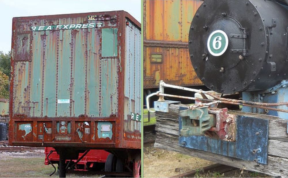

I had my #6 hat on today, Sammy, and this is what happened... LOL

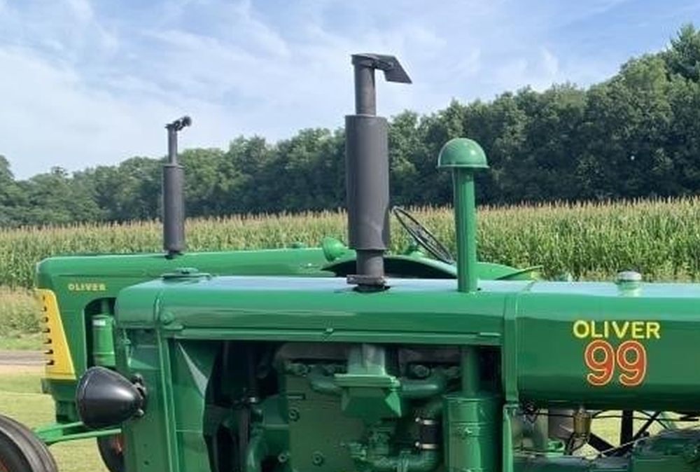

McHugh's green looks more like DuPont 5316, Sammy, which is the later Oliver green...
https://www.mchughlocomotive.com/locomo ... h-baldwin/
Here's a pic of both postwar Oliver greens together, the earlier DuPont 1317 Green in the front and 5316 Green in the rear. The equivalent of DuPont 5316 is the more common Oliver green found in the paint aisle of the local ag store and is often called "Meadow Green"...
