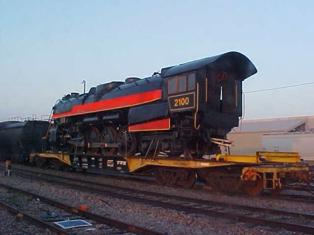

I wondered if disassembly was required? I recall when I moved this engine, the tonnage profile showed 303 tons (including the flat car). I googled the weight of both engines, they are within 5,000lbs

Finderskeepers wrote:
I know when we moved Reading 2100 for Tom Payne (no need to comment about that), the entire locomotive was picked up and placed on an 8 axle QTTX flat car. I remember thinking this this must have an extremely high center of gravity, but it was not taller than our double stacks. I wonder how 1309 would compare with that size wise.
Here's the best information I can find. Note that locomotives shipped this way go "dry," empty boiler and tender. That probably accounts for at least a 30-ton weight difference in the locomotive alone, and would also change the center of gravity considerably.
http://www.steamlocomotive.com/northern/?page=pr
http://www.movingfullsteamahead.com/upl ... -Page-80(1).jpg
I'm surprised at how relatively short the wheelbase of the C&O H-6 is. The locomotive itself has a total wheelbase of 48 feet, 10 inches.
If you look at the picture I can see everything on the locomotive including the stack. So as long as tunnel clearances are good and she is not too wide moving it this way is more efficient then taking a chance on bearings that have been sitting for years going up in flames.
While its more expensive this way she can roll in a freight train without the speed restrictions of having the main rods off. I know with 1352 move she'll be cleared for 40 MPH while rolling on flat cars.
