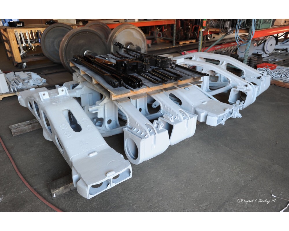

File comment: Tender trucks

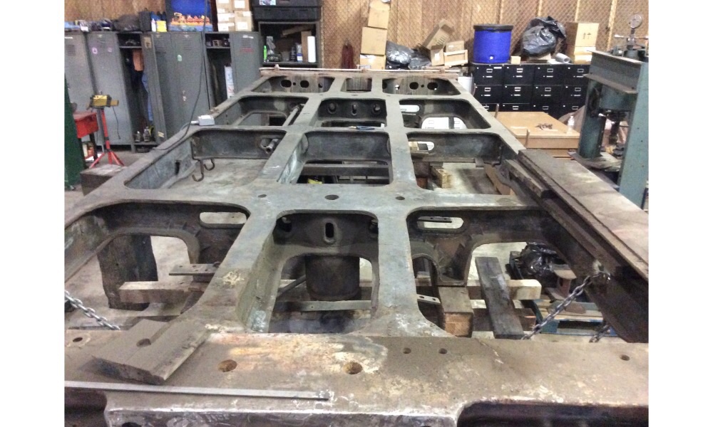

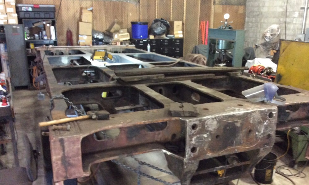

File comment: Tender frame work

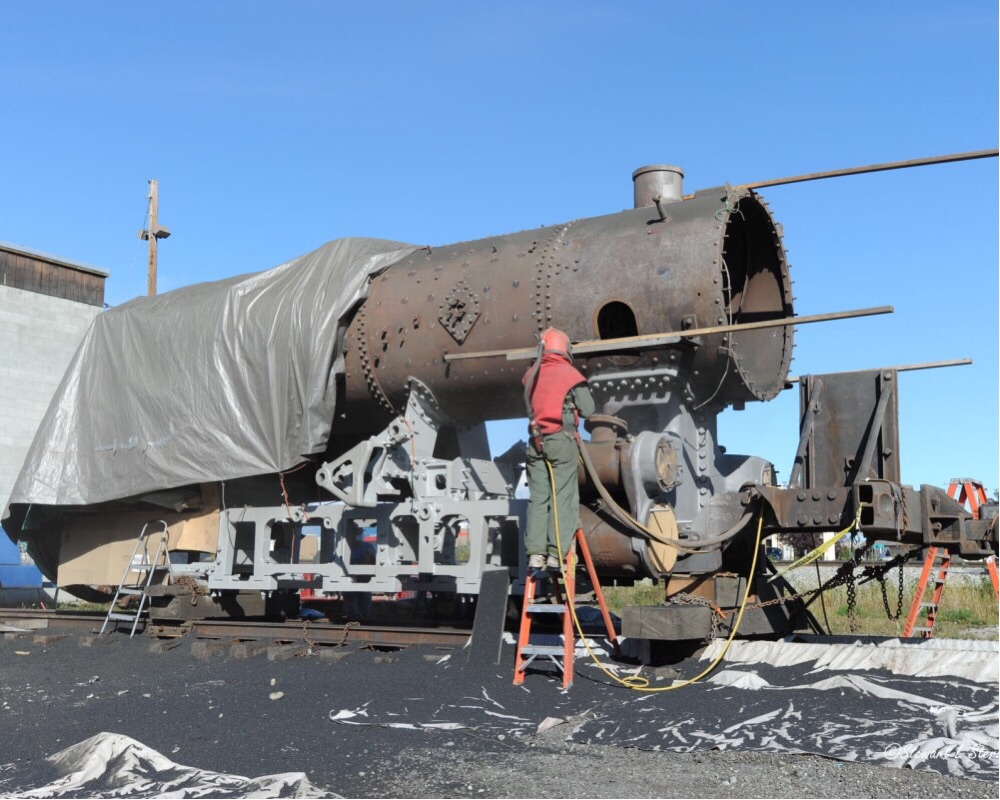

Some additional shots....
File comment: Oh the joy of sand blasting....

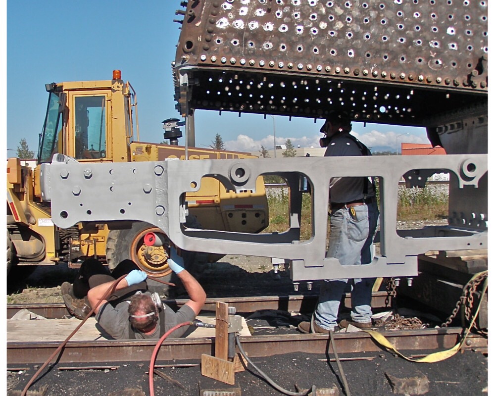

File comment: Frame
File comment: Crew working on frame

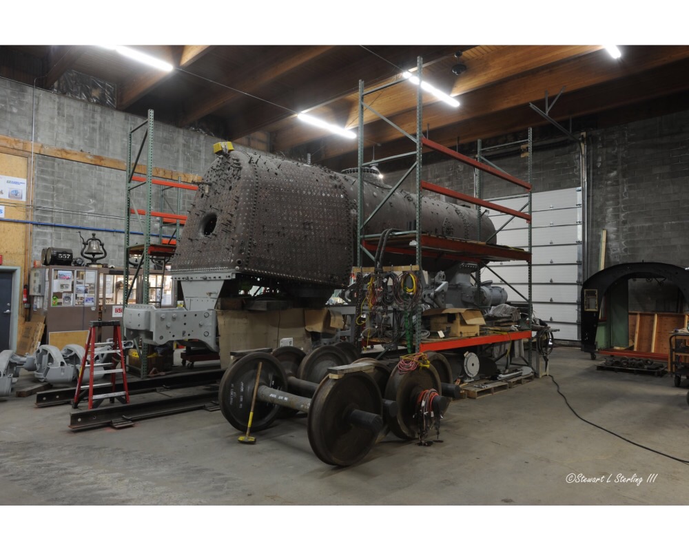

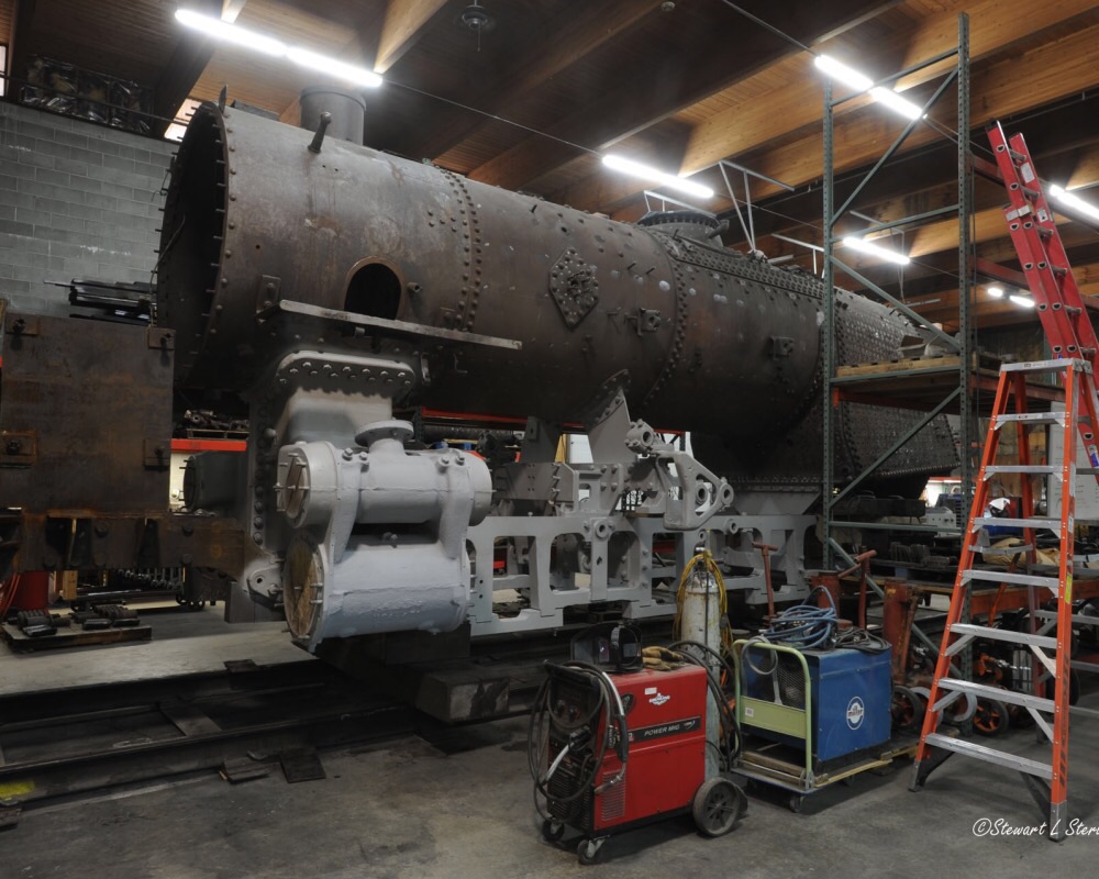

File comment: She's back inside for winter work.

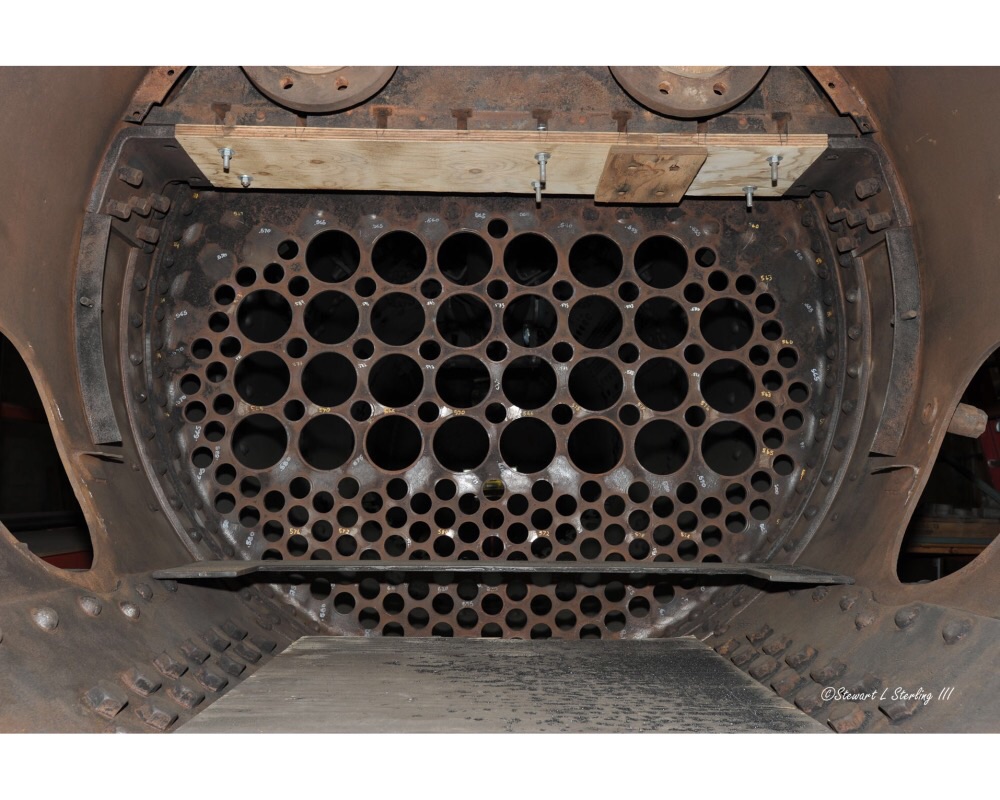

And a couple more....
Answer to the tender question while she was in Moses Lake. Last I heard the tender is still there. I will try and get an update as to the status of the equipment that was still at Monty's property.
Art

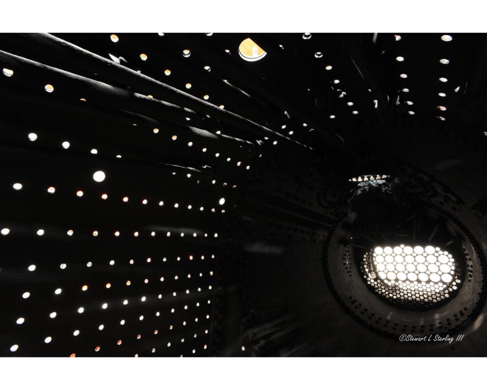

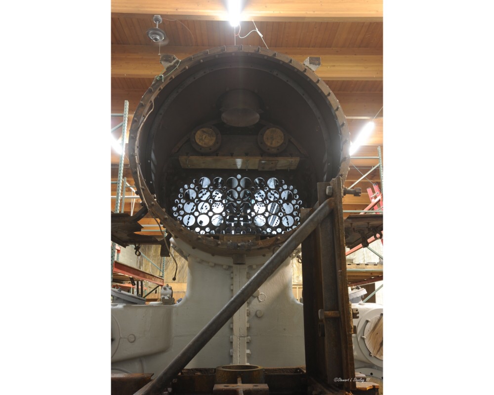

File comment: Front flue sheet.

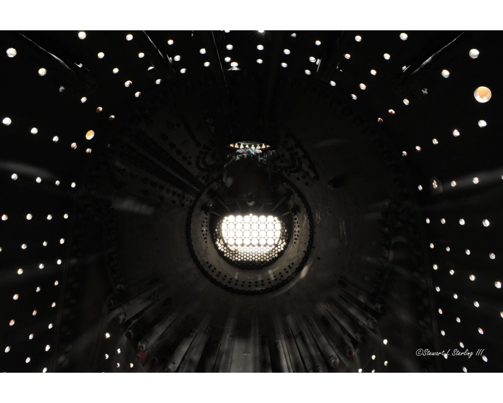

File comment: The firebox end...

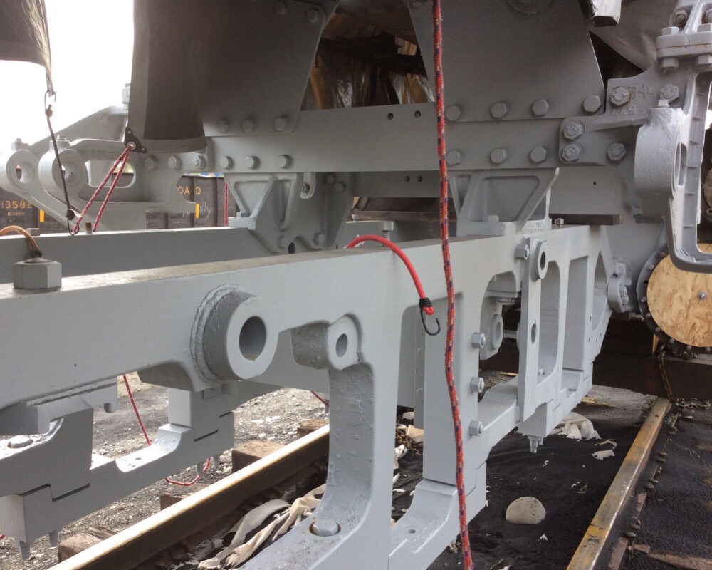

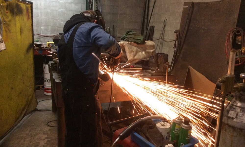

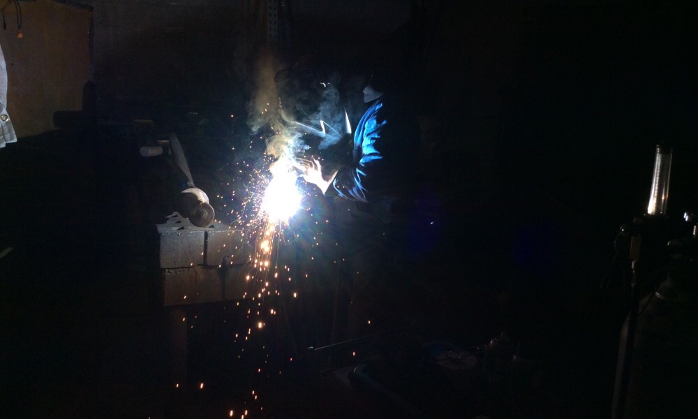

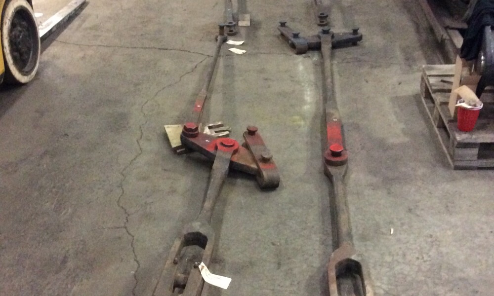

Thought you ight enjoy an update of the 557's progress. The loco was brought back inside and work continues on the peices and parts that get little noise but will be big in the reassembly process. Work this last weekend was on the brake rigging, building up pins on the equalizer bars and laying things out. New brass was applied to the power reverse guide and will be milled in the shop here. Work began on the superheater tubes. The fire box front and rear sheets are back and the side sheets are soon to join. Then the next major hurdle will be the installation of the firebox.
Fund raising has been going well and the matching funds are making this project move along well.
We appreciate all the interest and hope these photos will give and idea of the work.
Thanks
Art and crew.
File comment: Art working on equalizer rod pins.
