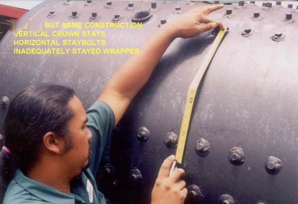

The boiler shown was built for the Lahaina RR by Benson Mountain. I had 22 ASME Code violations on my list when I told the RR GM that there are only so many bullets you need to put in a dead horse. The Asst. Dir. of Inspections for the National Board verified my 22 and added 17 more. The ASME directed the AIA Kemper Ins. to locate all Code certified components manufactured by Benson Mountain and verify Code compliance, bring the vessels into compliance or remove the Code stamp. Eight vessels out of 26 had the stamps ground off. Several were on private property and the NB was not allowed access. (Jason: The boiler you saw was that before or after the Code stamp was ground off? If the boiler has moved into the public sector, the NB would like to know its location.)
Mark,
Regarding timing of threads in the sheets, PG-47.1 says "stays screwed through the plate SHALL EXTEND BEYOND the plate NOT LESS THAN TWO THREADS WHEN INSTALLED". It does not say a nub shall extend.
I also have seen some creative code interpretations. I think the best of all was the electric steam boiler in a spa. It had a 15# hand weight sitting on the safety valve spindle. They said the valve was leaking steam and the label said 15#, therefore the 15# hand weight. That was a $1000 fine for disabling a safety valve.

Just how big are those stays, as they don't look much bigger than 1/2"? And what I want to know it, what AI looked at that said, uh, looks good to me......
what really gets me is they went to the trouble to flange the sheets, and then just flat out cobbed the rest of it up.
I would love to see the engineering drawings on that, and how that mess was calculated.
