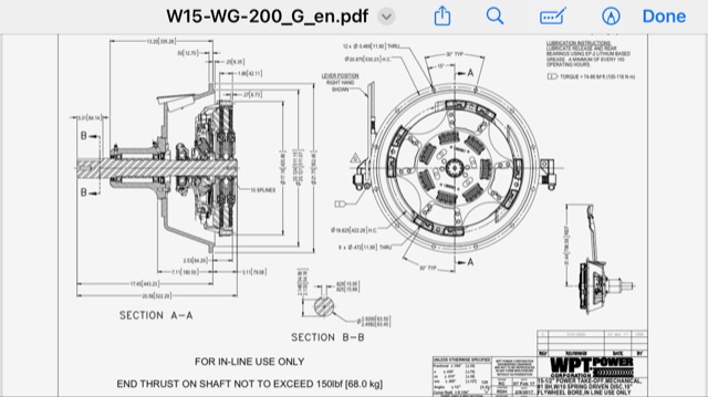

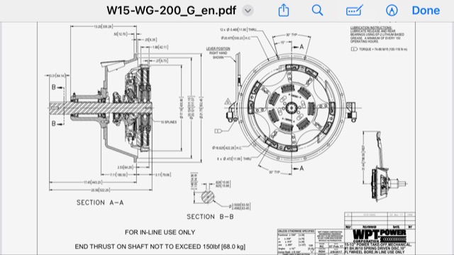

Here is the PTO clutch that I’ll be using.

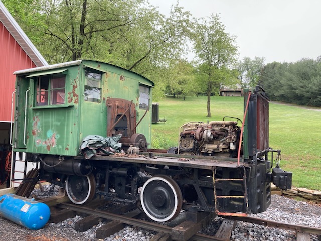

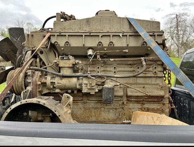

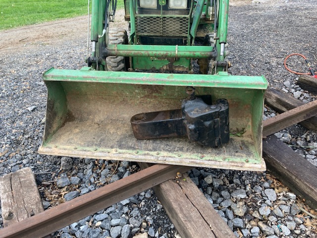

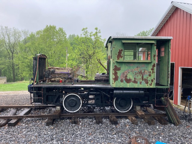

The engine is in place now.
Will mount it enough to hook up the cooling system, fuel system, then test run the engine.

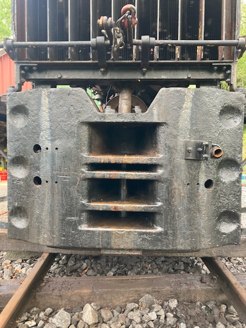

The front coupler pivot pin is broken just below the coupler. I was able to remove the top section and the coupler today. Getting the bottom part out will be a real chore. Not sure how I’m going to do that.
Will figure something out!
Busy, soggy Saturday. Made some progress though.

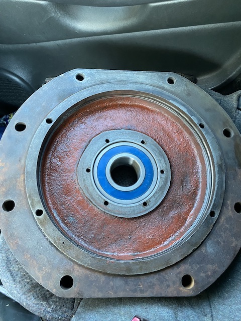

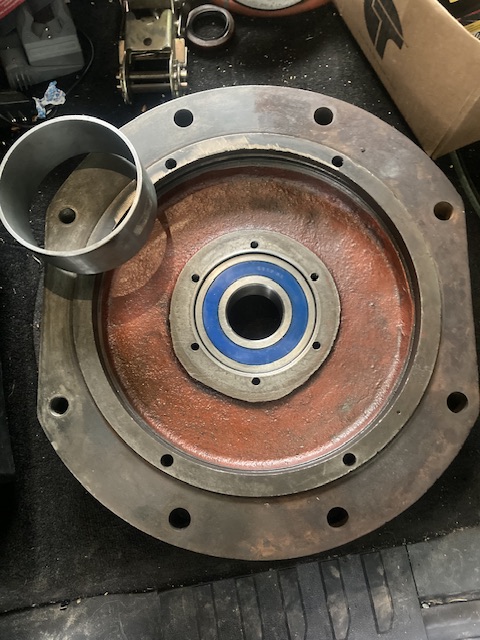

The input shaft housing is back from the machine shop.
The sleeve I provided was slightly too small so they made one the proper size. The new sleeve is just barely into the threaded holes. Looks like they ran a tap into the holes and it all looks great.
I’m still taking measurements and will machine the bearing retainer plate to fit. The spinning bearing wore it also.
Also bought a spare engine over the weekend. I’m going to convert my engine from a Low Flow cooling system to a High Flow. This new engine should have the parts in need.

I repaired the bearing retainer today and reassembled the housing.
We’ll see how strong I’m feeling tonight. I may install it in the transmission. It’s 140lbs assembled.

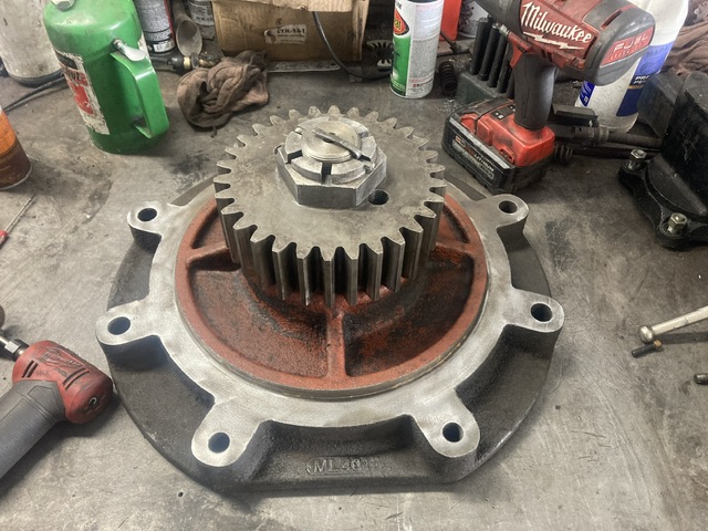

Turns out that I wasn’t feeling very strong that day.

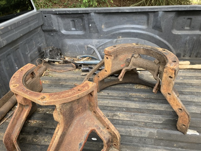

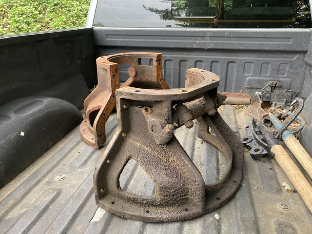

In addition, the bolts that attach the input housing also mount what I’ll call the “bell housing shell” castings. The whole thing gets bolted and the input housing is sandwiched in between.
I loaded up the bell housing parts tonight. Will clean them up and add some paint.
The clutch release forks will go away, but I’m keeping the small lever for the input shaft/clutch brake. Will be nice to stop that input shaft from rotating before engaging a gear!
