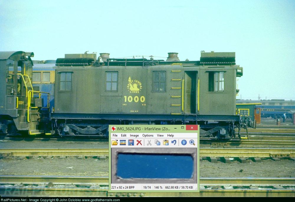

The B&O also used 014 Imitation Gold and the CNJ also used 5370 Bando Blue so this is what happened to CNJ #1000 when I lined up both the CNJ and B&O blues with the masked picture of 3380 GMC Ferrara Blue. Got the Pullman Green to really pop here...

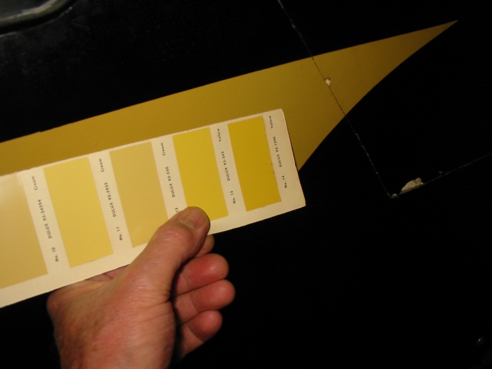

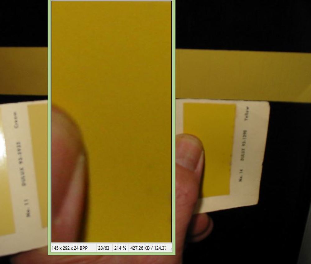

On the T-1 and cab model cab models, the yellow is applied over the black which does darken it a bit and could possibly make it look more like Imitation Gold instead of Venetian Yellow so if any of you guys are noticing the slight shade discrepancy between the paint and chip in the above picture, that would be why...

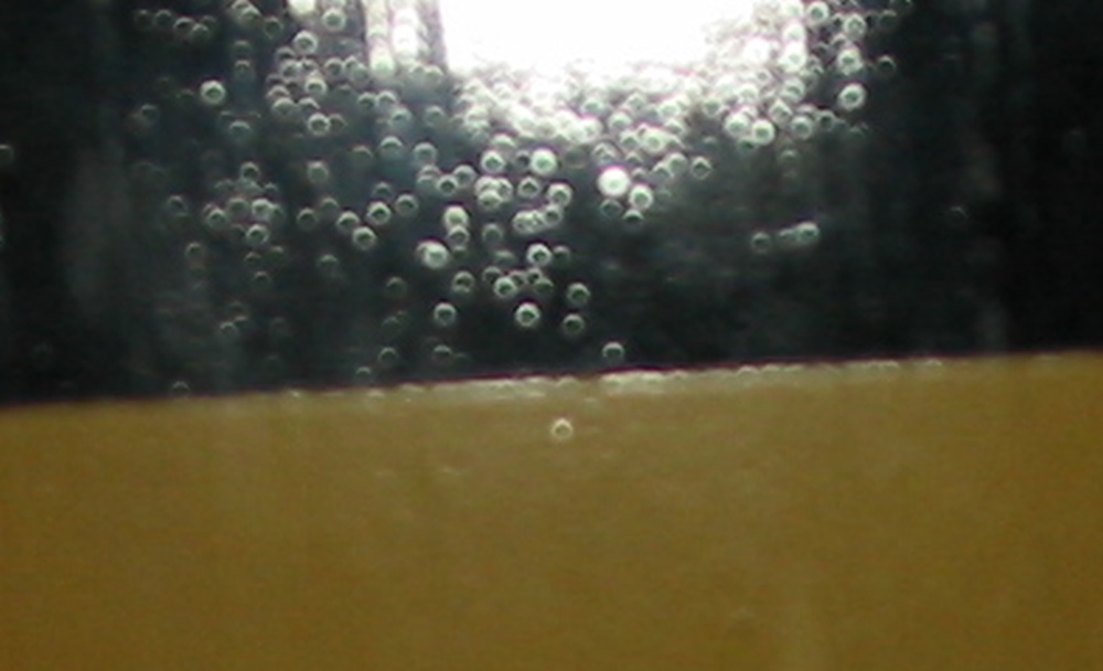

Here's another look. The yellow appears to be developing some thinner spots as well so I hope the museum staff isn't getting a little too aggressive when they're spray-and-wiping all the visitor scuzz off these things... ;)

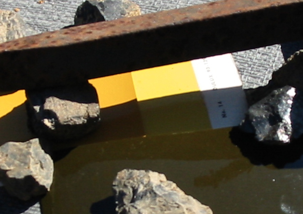

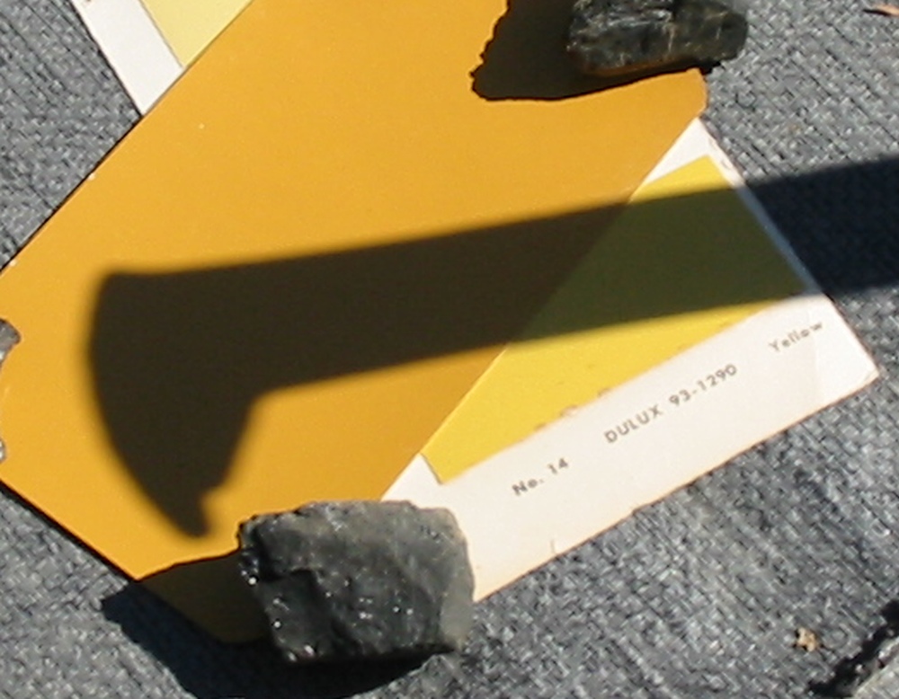

Yesterday was a good day to conduct the first shadow experiments with Imitation Gold and Venetian Yellow and here is the result. I'm guessing you might have to add about 25% more black to Venetian Yellow to get it as dark as a Pullmanesque color made with black and the real Imitation Gold but that's just a guess. The shadow on the Venetian Yellow chip may be a bit lighter but it's definitely greener...

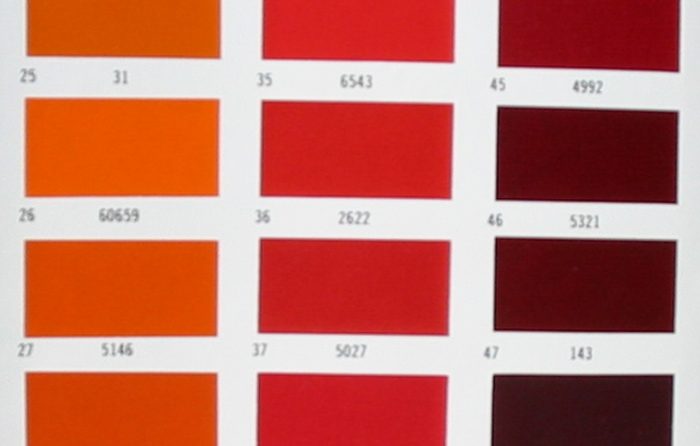

Well, that's all going to have to wait for now since the big news is that the Reading's red caboose red is very likely the same color as DuPont 5027 Red as shown here on the chart right under 2622 Scarlet...

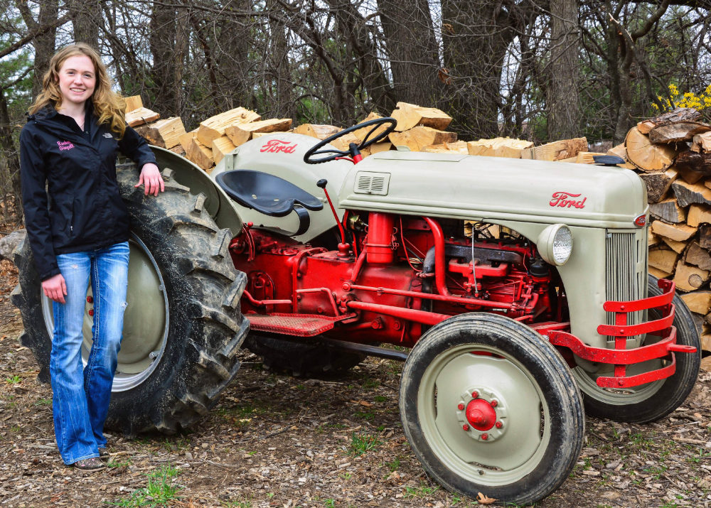

The color I'm looking at is DuPont 1024/55141 Ford Vermilion Red which is on the VanSickle chart as #480 Ford Red as used on Ford's 8N tractors so now we can pick up where we left off here and there and see why.
Scroll down to Page 50 in the big list of DuPont tractor and implement codes and you'll find the Ford reds...
http://www.rodnh.byethost12.com/misc/du ... es.pdf?i=2
Dulux 028 crosses to G9346 but I could not find any further information on that code. Dulux 034 crosses to 5027 so that's confirmed while 7410 has been pretty much put back in the barn.
Next, we'll head on over to PaintRef again and check the Ford Tractor codes there. 1024/55141 Ford Tractor Vermilion is the odd man out and the timeline looks good also...
https://paintref.com/cgi-bin/colorcoded ... el=Tractor
Ding, ding, ding, ding, and congratulations, 028 is much more very likely to be the equivalent of 1024/55141 and we now have the first of what may turn out to be quite a few alternative examples depending on where else we might find this color...

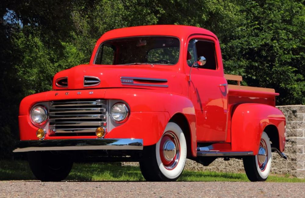

Ford used 1024/55141 Vermilion Red on its trucks from 1945 until the 1956 model years...
https://paintref.com/cgi-bin/paintdetai ... 246-55141R
Here's a nicely restored 1950 F47...

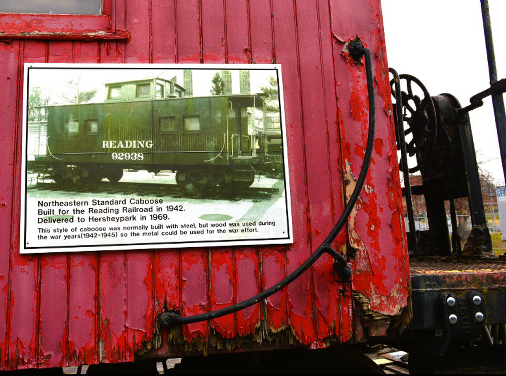

Here we can see the original Reading red caboose red showing through the later coat of faded and peeling Hersheypark happy red on #92938 at Hamburg. Still looks like it has some battery life left, huh?... LOL

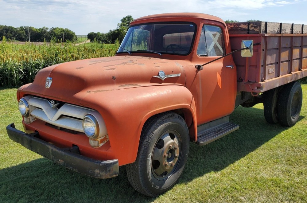

I'm still trying to figure out how I got this color so confused with Scarlet but I guess that can happen once and a while after spending too much time out in the sun... ;)
