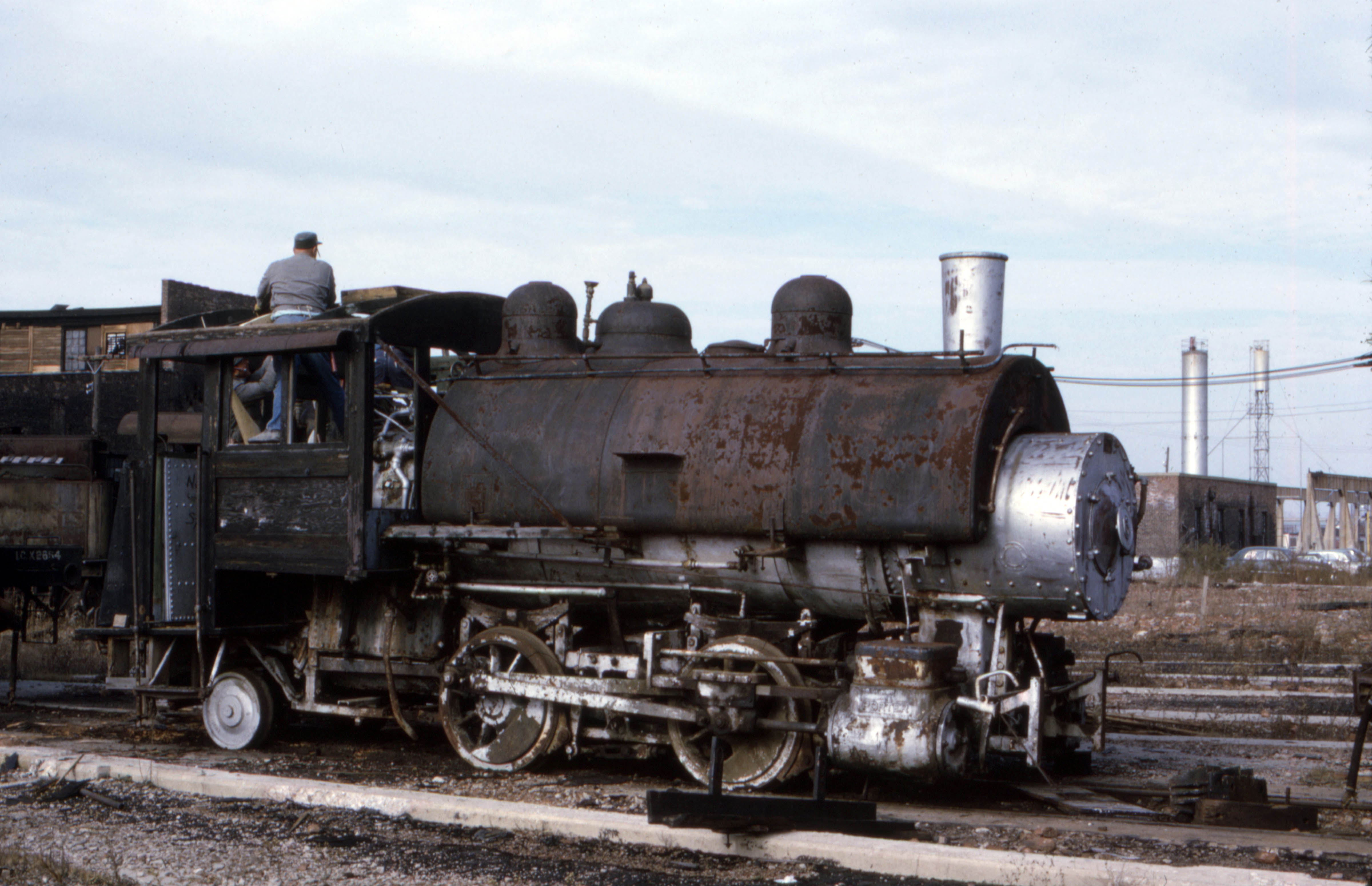

We don't have much new to report on Audrey at the moment but look for some news soon. In the meantime J. David Conrad has graciously dug up and shared some "new to us" photos of Audrey. The first one is in the 1960s at the IC Markham roundhouse where she was prepped to go to the Thompson Winery. It appears her cab roof is being given some attention in this photo.
We're always interested in finding new photos and stories related to Audrey. Many thanks to Dave for the newest batch of photos.

In my photo taken at Markham, the locomotive was being repaired prior to being moved to the farm, not the winery, John hadn't thought of becoming a vintner yet. Later, it and the four lumber company locomotives were moved to the winery. The 4-6-0 and the 2-6-2T which were at Markham, moved directly to Monee on their own wheels (on the IC mainline, luckily without incident) and then trucked to the winery. The 0-4-0 fireless was out there too for a while.
The winery was most impressive! Everything (except for the former railroad stations and the vines) were brand new. The tanks and equipment were imported from Europe as I recall. The vines didn't do well in Illinois. Most of the wine which Thompson made in Monee came from grapes from elsewhere and just processed at Monee. I was given a bottle of the first batch produced. The wine was quite forgettable but I wish that I had saved the bottle which as I recall, featured a line drawing of the 4-6-0.

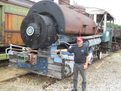

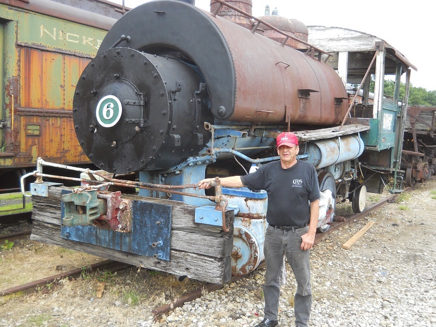

I was going through some photos recently and found this one. Don't think this thread has any shots of Sammy and "Audrey" together, when 0-4-2T #6 was still at the Hoosier Valley Railroad Museum in North Judson. The photo reminded me that the Porter is pretty good sized for a 4-drivered saddletank lokey. Wonder where she might rank T.E. wise, compared to other engines of her type?

Ah yes, Les, the first steps taken on an unexpectedly long and steeply graded road. The sun was threatening to come out, and this picture recalls the taste of Marlboro 100s and pit stop coffee, from a time when I wasn't nearly so old, ugly, and grouchy... To partially answer your question, Audrey isn't a store bought Porter back truck type. She was built in 1913 as an 0-4-0T, and her specifications most nearly approximate those of the lightest example of Class B-S, Heavy Four-Wheel-Connected Saddle Tank Locomotive, as shown on page 18 of the 13th Edition Porter Steam Locomotives Catalog. They list her with correspondence code KLEPEL, having a tractive effort of 15,000 pounds, and her most recent scale ticket was 60,000 pounds. This weight is minus woodwork, appliances, fuel, water, sand and lube oil.
I'll leave it to somebody more scholarly than I am about steam locomotives to finish answering your question.
