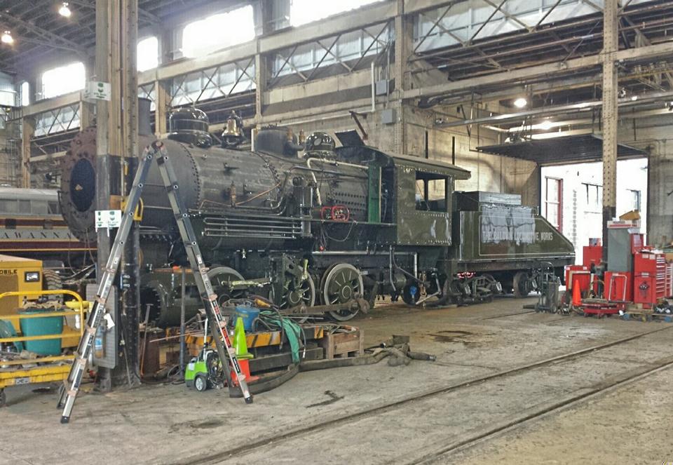

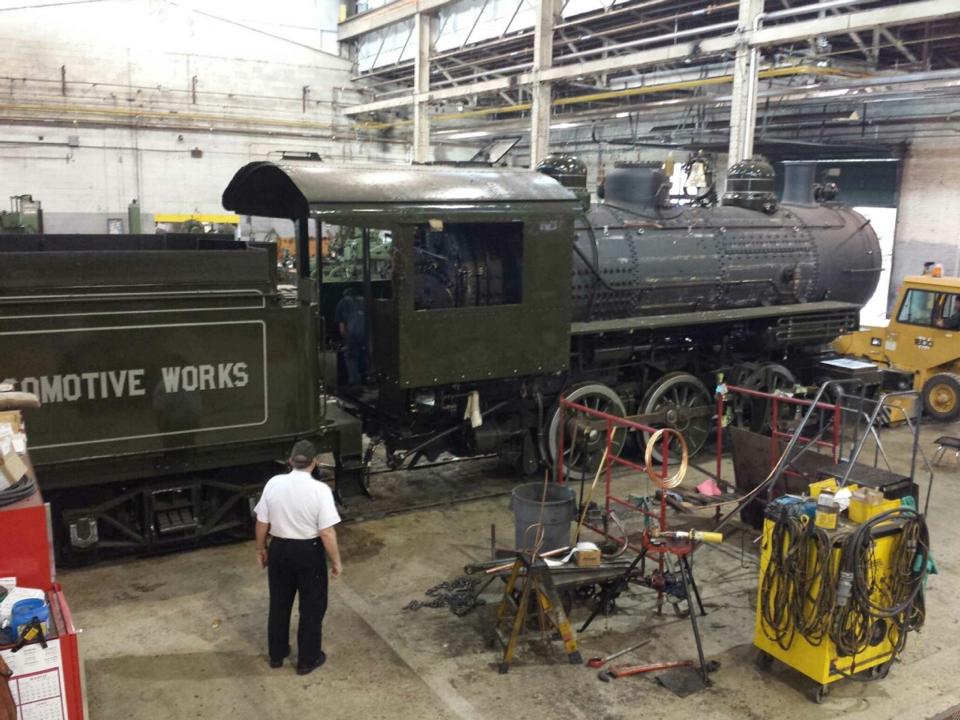

Today, the National Park Service posted two photos of 26 on their FB page. According to the NPS post, it has been about 14 years since the loco was mated to the tender. Photos show that the spring adjustment to the tender springs worked nicely and that the tender appears to be at the correct height.
According to the NPS post, 26 has not been fired up since December, 1999.
The pistons are still out, as are the valves and valve gear. There is no discussion as to whether or not the "FRA paperwork" mentioned in the "Citizen's Voice" article dated August 24, 2014 by Supervising Exhibit Specialist Barbara Klobucar, the person who is the supervisor of the shop, has been completed nor is any information provided as to the nature of that FRA paperwork.
NPS photos, Kenny Ganz
