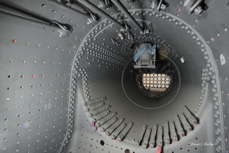

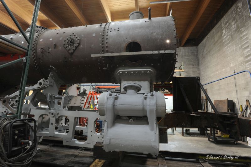

I can report some excellent news and a productive summer.
The news is that the Atwood Foundation, a local foundation established for the benefit of the people of Anchorage, Alaska, has awarded $50,000 to support the restoration. All $50,000 will be matched by and will nearly exhaust a $350,000 challenge grant which was awarded in mid-2012 by Alaska's Rasmuson Foundation.
The Engine 557 frame, boiler shell, and cylinder assembly has been slid back into the engine house for the winter, just beating the first snow flurries of the year. In addition to what has previously been reported, the cylinder block, most of the frame, the tender frame and trucks, and boiler interior have all been subjected to several hundred hours of scraping, needle scaling, sand blasting, and painting. Paint was high temperature primer, epoxy primer, or Apexior 1, as appropriate.
The very generous contribution from the Atwood Foundation took us close to meeting the original cost estimated for the restoration. Unfortunately, the condition of the original firebox and need for it to be condemned and totally replaced set us back a number of months and upwards of $400,000. Our fund raising team is pursuing a number of sources of additional funds. Contributions are gratefully accepted!

I too have heard the stories that the boilers for this locomotive design were in some way substandard, but can now refute it. The quotes below are from the the BLW specifications for Alaska Railroad locomotives 551 through 554. With minor differences in a few internal components, boilers for the War Department Consolidations, including 551 through 557 and all but the last locomotives to the design built by all three manufacturers were to the same design and used the same ALCO drawings. I have verified this through a review of the drawings and drawing indexes for the order covering 557, the first BLW order, and Lima's drawing index. I have read but haven't been able to document that the boiler for the final locomotives produced to this design included modifications from the original design.
"Boiler built to comply in all respects with the A.S.M.E. Boiler Code, except that the shell shall have factor of safety of 4."
Each boiler shall be tested in conformance with A.S.M.E. locomotive Boiler Code. Any leaks developing may be calked, but the test shall be repeated until all leaks are stopped. After A.S.M.E. tests the boiler shall be fired and the pressure raised to 245 pounds per square inch, and shall be steam-tight at this pressure. After steam test the boiler shall be blown down and allowed to stand until it is cooled. It shall then be refilled with water about 150 degrees F. and the pressure raised to 245 pounds by firing. The boiler shall remain steam tight until thoroughly cooled down.
Made of plates of homogeneous basic steel for a pressure of 225 lbs. per square inch, and tested with steam to at least 20 lbs. per square inch above the boiler pressure, and with hot water to one-third above the boiler pressure.
We understand that the last locomotives to this design used 7/16" plate in the crown and side sheets. To give us a bit more of a safety factor and more of an allowance for future wear, the replacement crown and side sheets will be 7/16".
The Alaska Railroad's marketing plan is to operate from Anchorage to Portage, where there is a wye, and return. About a 100 mile round trip alongside some spectacular scenery. We expect that a water supply will be set up at Portage. Other, special excursions are also in the cards. One that is likely is for at least some of the annual excursions from Anchorage to the Alaska State Fair in Palmer to be pulled by 557. Another possibility is an occasional excursion north from Anchorage to Wasilla, turning the train on a new wye a few miles north of Wasilla.
There will be some additional logistics to take the locomotive farther afield to deal with water and fuel. The details for this type of trip haven't been worked out.
While we are trying to maintain the original fiber and appearance close to original, 557 is going to have to earn a living, run at track speed, and not get in the way of other passenger and freight traffic being pulled by locomotives that are 65 years younger. We will make several improvements to improve reliability, decrease maintenance, and meet current practices and requirements. Examples are the boiler upgrades and use of roller bearings on the lead and tender trucks.

Dick, thank you for posting the update and photos.
What coating was used on the boiler interior? Apexior, or something else?
Chris Webster
 Post subject: Re: Alaska Railroad 2-8-0 #557 to be returned to service!
PostPosted: Fri Oct 10, 2014 10:32 pm
Posts: 706
Location: Anchorage, Alaska
We saw the Lempor conversion, but decided not to pursue it.
Boiler interior is Apexior 1.
