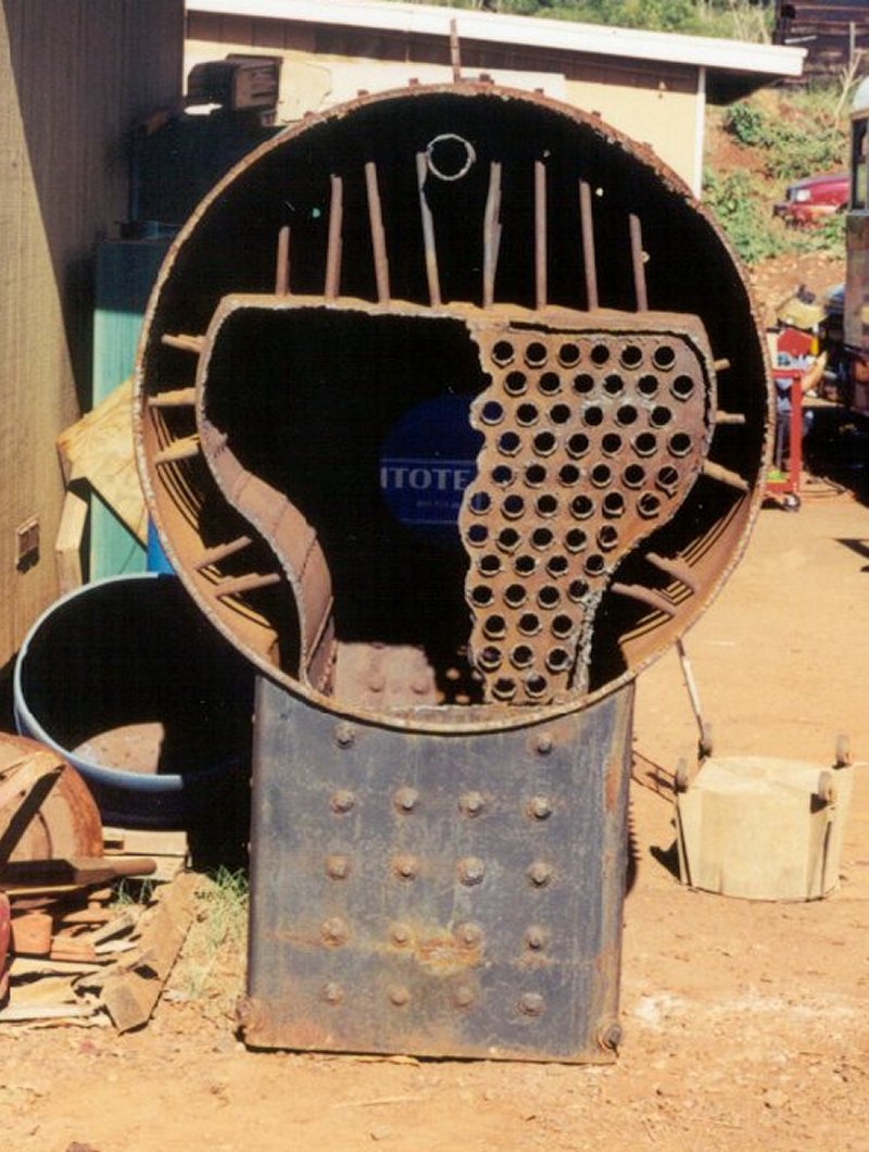

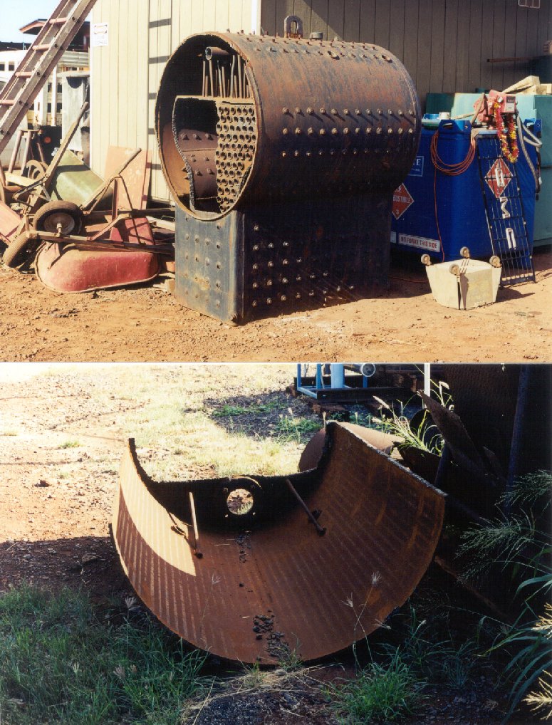

 Post subject: Re: From the TRAIN News Blog (Re: New Locomotive Boiler Code)
PostPosted: Thu Mar 04, 2010 7:12 pm
Posts: 488
Dave wrote:
We seem to have a pretty good grasp on building them safe
WE DO???
PostPosted: Thu Mar 04, 2010 8:02 pm
Posts: 543
Location: NE PA
Matt,
Any details as to what happened with this boiler?
Thanks,
Mike Tillger
PostPosted: Thu Mar 04, 2010 8:55 pm
Well, not all of us........but thanks for reinforcing my point about education and qualification.
What didn't happen? Was this made in a very small New England state?
dave
PostPosted: Thu Mar 04, 2010 9:40 pm
Posts: 490
I, too, have seen a quality product of the same company that likely built the boiler/firebox referenced above.......
Recently I was made aware of a new boiler with threaded stays, where the builder didn't know to use a long staybolt tap, and hence the threads in the sheets are not "timed" together. The stays were screwed in and crossthreaded...and driven, and driven, and driven until it would hold water.
The problem is that the code (ASME) makes some assumptions when specifying construction criteria that can lead to disaster:
1) Nowhere in the code does it say that the threads on adjacent firebox sheets shall be timed to accept the threaded bolt.
2) Where does the code say that a staybolt has to be straight?
3) In the most recent ASME section I, a firetube boiler only has to have 4 washouts. The older reference to "traction or portable", or "locomotive style" boiler having to have at least 6 washouts/hand holes has been dropped.
As an inspector, I have seen and had to accept/pass boilers that were built and stamped to ASME code that I thought were substandard. However, due to the fact that they met code and had the appropriate paperwork, they were deemed "OK".
