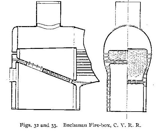

It was bugging me that I saw this and several other lesser-known fireboxes somewhere. Then I remembered where: Grimshaw's Locoomtive Catechism, 1908 edition. Here is what Grimshaw says about the Buchanan firebox:
" It is used very largely on the NYC&HRRR, and its peculiarity consists principally in a water table, as shown in figs. 32 and 33, inclining from the back plate down to the tube-plate just below the bottom row of tubes, and dividing the box into an upper and lower compartment. Through it, there is a round opening about 18 inches in diameter, through which must pass all combustion gases, smoke, and air, the intention being to cause them to mingle before they strike the tubes. There are four tubes in the front end and four in the back, just above the fire, to supply air above the grate. Each has a conical nozzle through which may be passed a steam jet which will draw in an air current. "
Among other things, I wonder if 999 had this type of firebox when built, since both seem to be the creation of the same person, William Buchanan, master mechanic and superintendent of motive power at NYC's West Albany Shops.
Steve, Thanks for posting that information. I think I understand the water arch concept, but I am a little puzzled about this part from the description:
“There are four tubes in the front end and four in the back, just above the fire, to supply air above the grate. Each has a conical nozzle through which may be passed a steam jet which will draw in an air current."
I don’t see that in the drawing, and it would seem to be quite a unique feature in its own right, beyond the water arch concept. It says that the tubes will provide fresh air, but they actually introduce steam, which will draw in air apparently from some other source. Other than gas producing fireboxes, has there ever been a design (other than the reference in the above description) to jet steam into the firebox for any purpose?
I believe that "overfire jets" fit that description, they were used to help eliminate excess smoke.

That's interesting - the 4-4-0 I'm modeling appears to only have one of those openings on the back of the combustion chamber - right in the center. I haven't added it yet, but it does help to know a little more about it. But, no steam jets, just a pipe. It is a Buchanan firebox, and it's a NYC&HRR engine. I've got the number around here somewhere - don't know it right off hand, but I remember it was a two-digit number.

The opening between the two sections of the firebox are (on mine) not round, but oval-shaped (from memory, I think it was something like 17"x23") and the "extra air" pipe is roughly to scale with the drawing posted. It's much larger than the copper pipes appear to be in the PRR engine (thought I'd clarify that due to the comment noting the similarities between the two). Somewhat of the same concept, apparently, but not executed quite the same.

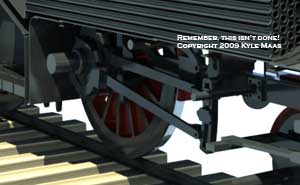

Been a while since I posted an update, so here you go. Valve gear's just about complete on the NYC&HRR 4-4-0:

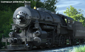

And, I figured as long as I'm posting about the 4-4-0, I'd post a shot of this other one I've been picking away at:
It's a Michigan Central Consolidation, modeled from an old blueprint. It's not cross-sectionable though, due to the fact that the source blueprint is not detailed enough. I could do a rough guesstimate of the inside, but it just wouldn't be accurate, so I left it as an external shell. There are still a few details missing, but I think I'm just about ready to call her finished.
