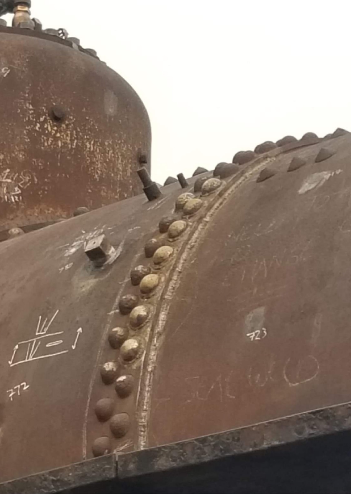

From what I understand, Wasatch did not ever raise the "we didn't do that shoddy work" to either the FRA or in the arbitration. One can draw a conclusion that in fact, that is the work of their "professionals" and contractors.
The work also bears the telltale signs that Wasatch is known for, like seal welding around rivets, which from what I understand, is not necessary or really seen as acceptable.
Then, if you look at the work Wasatch performed on Nevada Northern 81, you see the same telltale signs of shoddy work.
In the first photo, we see welding around the seam of a boiler course, and seal welded rivets in the joint between the boiler sections (are they called courses?). I have submitted a FOIA request to the FRA to see if Wasatch or NN filed the paperwork to get approval to weld on an unstayed portion of the boiler. In the second and third picture, both taken in late September (the third is on NN's Facebook page), we see a gauge tested in October of 2020, AFTER a date then in the future.
I know people want to keep "an open mind" because it's easier than taking side, but how is any of this excusable?

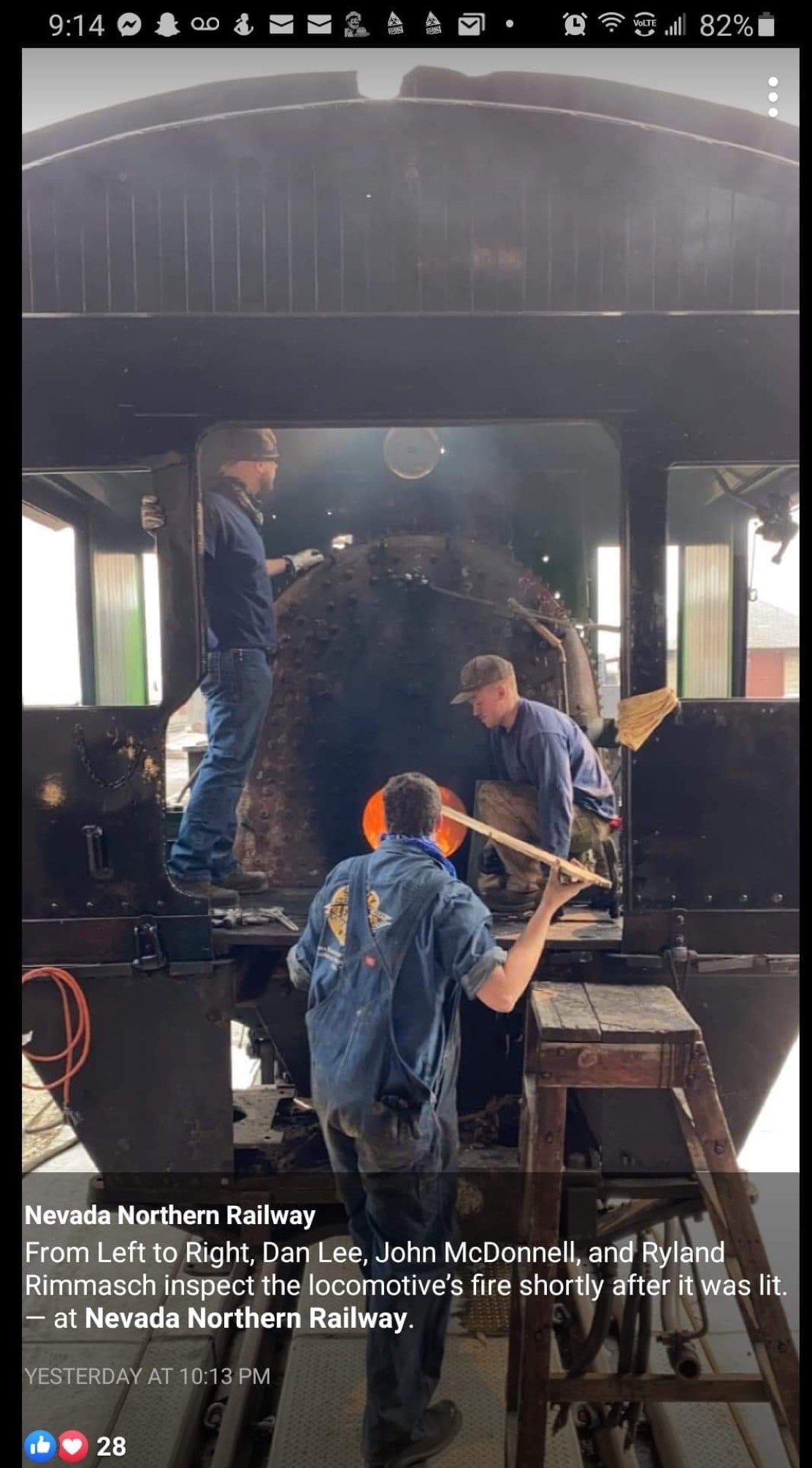

And here's a pic of the fireup of the 81, with Wasatch employees, not contractors, present, and not even one, let alone two sight glasses on the backhead.
