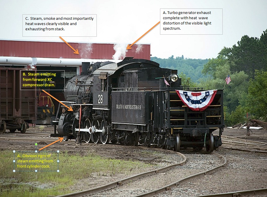

So it was ran on air but compressed air doesn't make those thick clouds of white steam when the whistle is blown. Are they sayind they're photoshopped? Also, the photo of it sitting in front of the shop builidng with steam coming out of the dynamo and a nice thick column of hot air and wisps of smoke doesn't look like compressed air to me. If photoshop is the case that's pretty impressive!

Cloquet Terminal Railroad
Everyone out there who is in such a uproar about #28 being out this past weekend needs to take a chill pill. There are several pages of exchanges on different rr sites arguing about if #28 was running under its own steam pressure. #28 can travel using several air compressors, and a generator. NO steam was involved. A small fire using scrap wood was used to provide the smoke to give the people at the Independence Day celebration a good show. If you still have more questions stop by the CTRR shops in Cloquet, MN and come and see it in person. We are always happy to have visitors! Updates WILL be posted on FB and it will be noted when it is moving under its own steam power.
I call bulls**t, I really do not care what anyone says. See the attached picture for my reasoning.
That excuse is ever so convenient and highly suspicious indeed, namely because of how the most telling photographs were immediately taken down once people started asking questions. I am still 99.99% convinced this locomotive was under steam, with a fire in the firebox. The picture is inexcusable (or exquisitely doctored I might say!). The .01% of me that buys this load of crap is the part of me that believes someone over there is an unsung messiah of Adobe Photoshop. Unless someone can PROVE otherwise, they've gotta do better than a lowly FB status update.

Service day. Any calendar day that the boiler has steam pressure above atmospheric pressure with fire in the firebox. In the case of a fireless steam locomotive, any calendar day that the boiler has steam pressure above atmospheric pressure.
Even if they charged the thing up on "shop steam" with wood in the firebox for effect (which I doubt for reasons Cormack was kind enough to ever so thoroughly illustrate) by definition it is STILL a service day.
