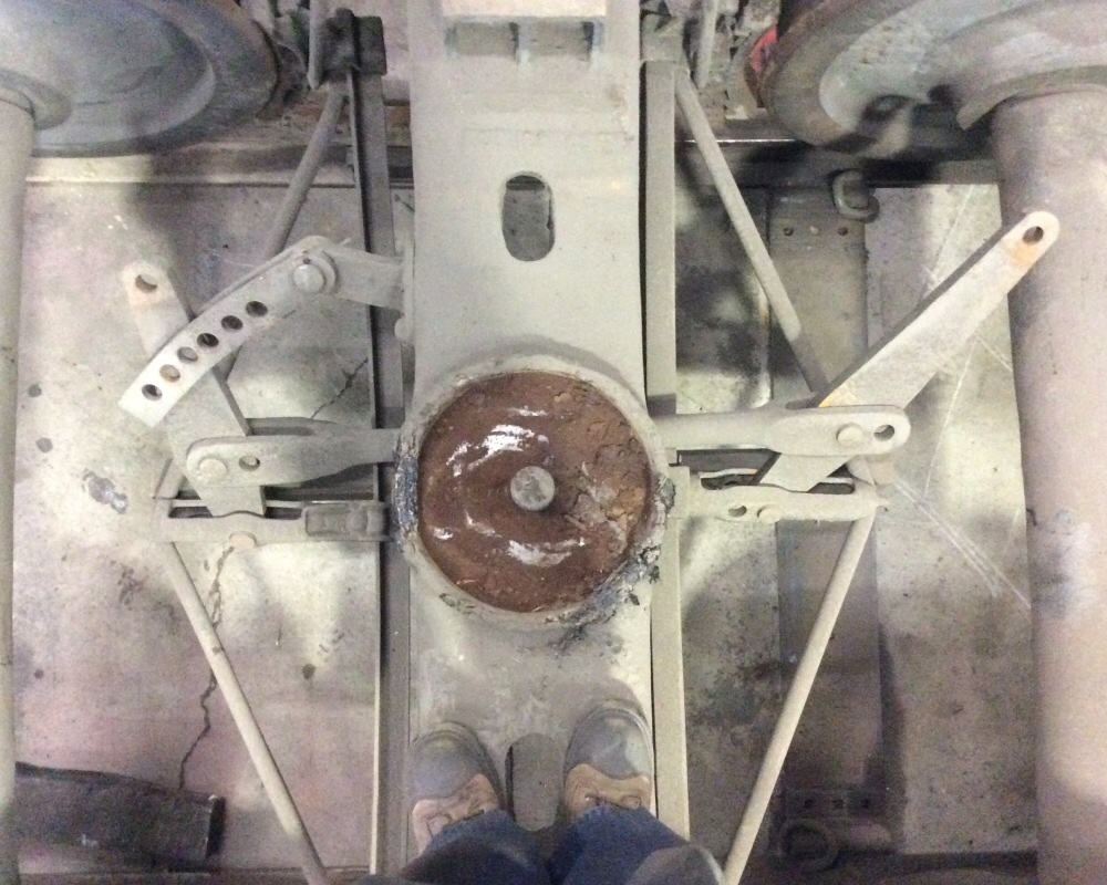

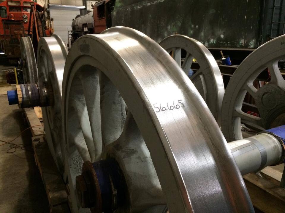

A little closer view...

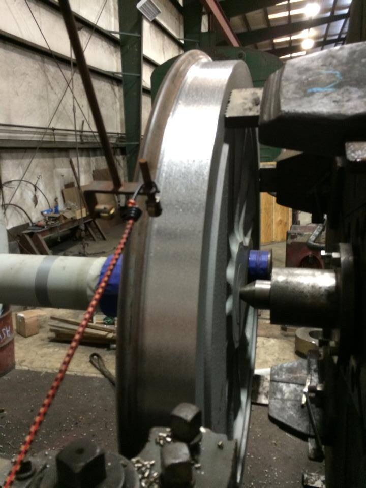

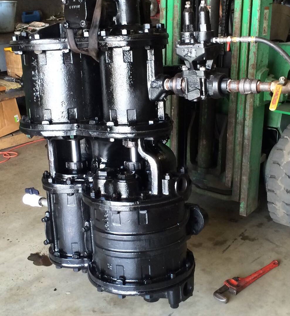

Just another shot of Steam Services of America's work.
File comment: Compressor

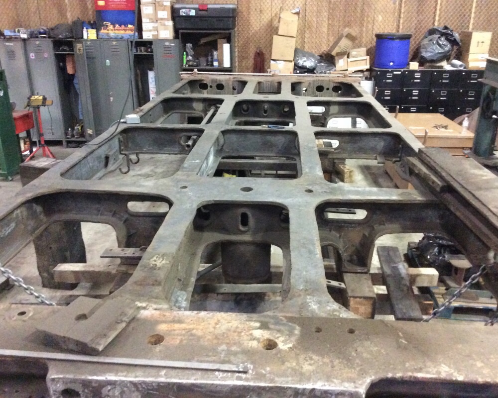

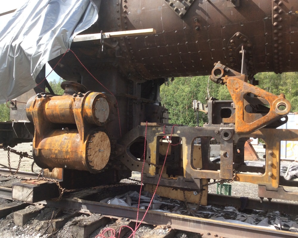

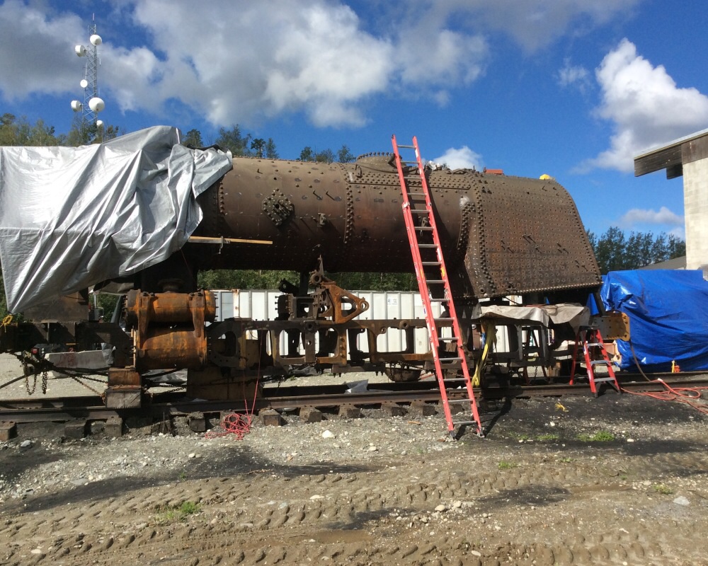

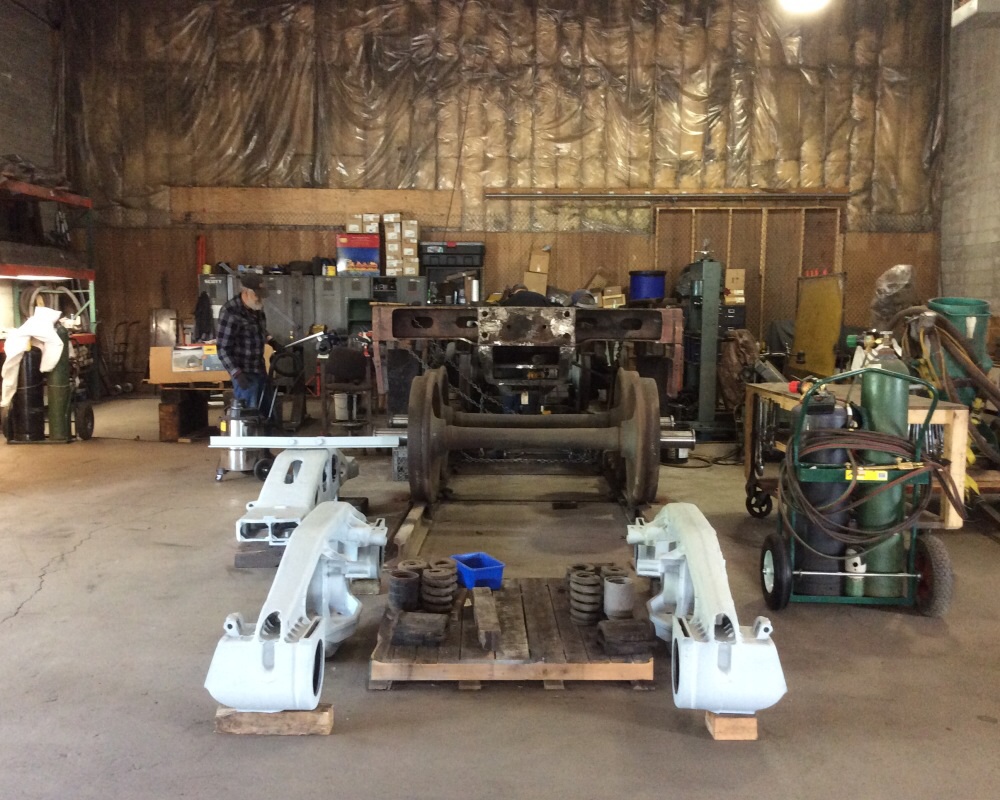

Work continues on ARR 557. This last weekend crews were working a few specific areas that will get things ready for the second half of the project, adding everything back together. Robert Franzen was in town looking at the work accomplished in stripping the boiler down and the sand blasting work that was accomplished. The barrel and firebox end have been cleaned, and additional parts from various smaller projects have been repaired, sand blaster and painted.
We also completed the stripping down of major components on the tender, lifted and removed the trucks that are being rebuilt. Enjoy the photos and if you can help or offer support, we appreciate it.
Art
File comment: Cylinders.
File comment: Enjoy some sunshine .... Finally

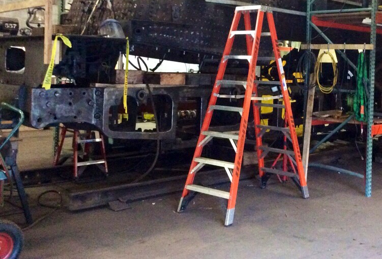

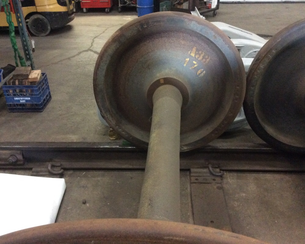

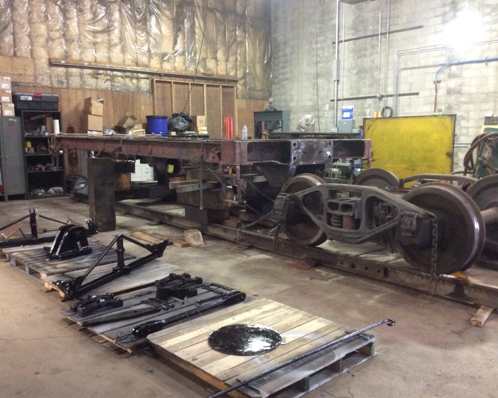

Last batch.
File comment: Tender frame
File comment: We even have new paint on our building!

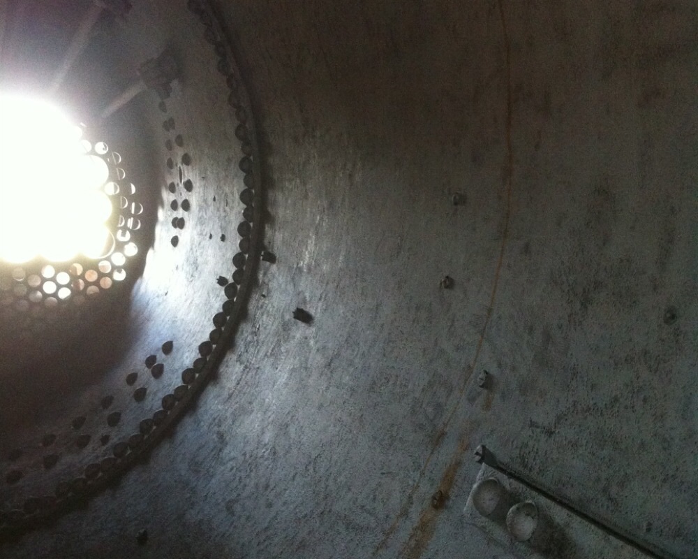

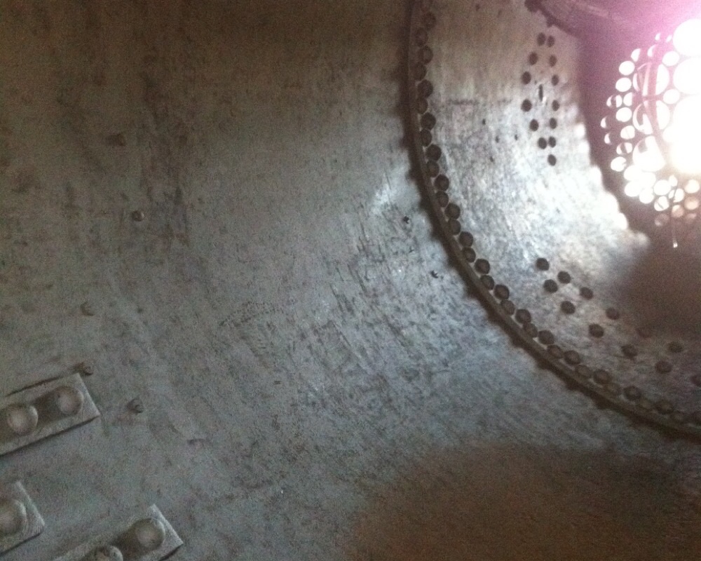

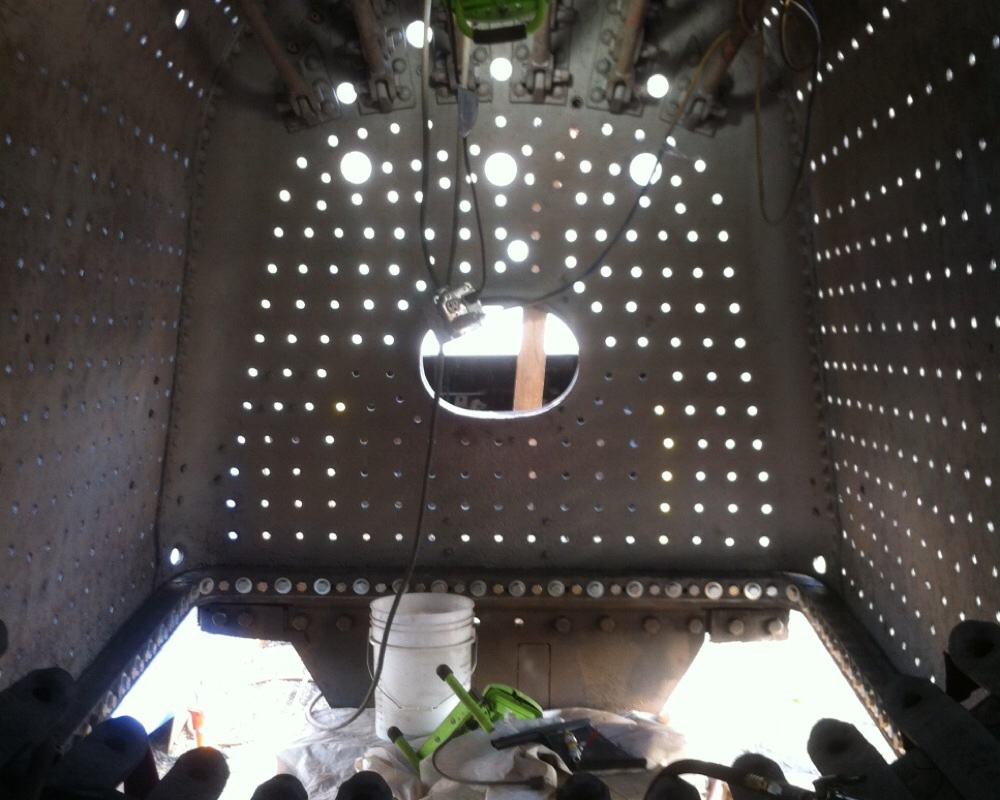

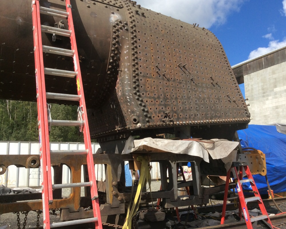

Here are a few additional update photos from this last weekends work. I can't tell you how happy I am to share what has been 22 months of work for the 557 crew.
Here you see the accumulation of progress on the boiler interior. There are a lot of man hours put into this locomotive and we all care about her a lot. These are the shots from inside the barrel and the firebox end. Soon, we will truly be on the positive side of the restoration efforts.
Thank you for all the kind words from the RYPN followers.
Art. aka 'the boiler rat'
File comment: And a firebox end..
File comment: Right side....
File comment: Left side of barrel...

In terms of mechanical soundness, how has the rust and deterioration affected the parts?
 Post subject: Re: Alaska Railroad 2-8-0 #557 to be returned to service!
PostPosted: Thu Jul 31, 2014 7:38 pm
Joined: Fri Sep 10, 2004 3:52 pm
Posts: 91
Location: North Pole, Alaska
So far, we have not encountered anything outside what forty years of wear and tear have shown. There where a lot of things that needed good solid rebuilding. Many of the critical items are in very good shape. The boiler and firebox need the usual attention after the long rest. The scale and rust on the interior of the boiler barrel where a little more than what was expected and I spent a few days removing hundreds of pounds of scale from the belly. ( oh the luck of being a skinny guy ). Many larger issues have only been found since we made the descission to take her to the frame and back. Pumps, power reverser, rods, bearings etc all showed the normal wear and tear.
As we have shared before. We are making this engine road worthy in every aspect. We are going to be expected to be able to hold track speed with our trains ...reliably... And with confidence from the railroad that we will not delay any operations. Period. So this is the driving force as to the depth of our rebuild.

One thing that stands out is that it looks like this locomotive has a bar main frame--and a cast tender frame. That's an interesting combination. I can understand the bar frame--this would have kept weight down, and be easy to repair in primitive conditions--but the cast tender frame, well, that's something that was probably paid extra for.

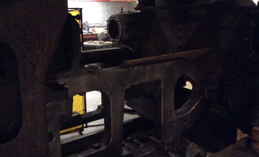

At first we thought so to, but I promise you, she is a cast frame. We where puzzled at first because of the design and look of all the frame sections, but as we began peeling the years of paint and grim off, we found a frame that was cast and "cleaned up" with some rough tough methods. It appeared to be cast and cleaned with flame cutting. Maybe it was a process far different from most standards, maybe a really rough pattern . Here's a couple pics from last winter as we where in the beginning of the project.
I have also seen various manufacture markings on the loco, she had parts from many of the builders. These war babies were a combination of parts, made fast, effective and with a purpose to win the war. And then be cast aside. That they actually made it many years after, and served the railroad well is a testament to the design.
