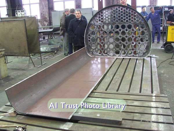

From reading through the various entries in this discussion, is it safe to say that Tross was trying to develop a staybolt that would function with a flat crown sheet firebox, versus a radial stayed firebox, which seemed to have far fewer problems?
I find it odd that the people who expound the German locomotive model seem to ignore the fact that in U.S. practice, flat crown sheets went away, and radial stayed fireboxes became the norn in the late 1870's.
Any comments?

I'm nothing like the expert John is - or probably many of our European posters - on German steam, but out of the few examples I have been fortunate enough to lay hands on I recall none having a flat crown sheet, more the common gently arched version we all are familiar with. I have seen some unusual (to us) staying by gusset plates on various parts of little 60CM industrial lokies from over there......In fact all my German steam hands-on has been in narrow gage industrial stuff. I suppose flat crowns might have been common on standard gage steam, but kind of doubt it if the little stuff didn't use it. An interesting perspective, for sure.

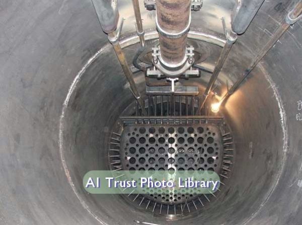

Not German, but looks flat to me......

Ummmm, yeah, Matt, it sure does.....but what does that have to do with German fireboxen and crownen sheeten? Actually, I have seen some ancient drawings of Yank flat tops with crown bars on old keyhole boilers circa 1870's or thereabouts as well.
Getting back to the original post, I think we are wondering if the German mainline standard was for flat crowns in the post-Tross era? Surely somebody with the relevant expeprience is out there and can provide some good information.
dave
Actually, is German. This was built by Meiningen. I know it follows at least some of the original A1 drawings, but is German design built to TRD code.
