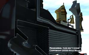

Once again, missing a bunch of parts and not complete, but here's a view that shows some of the backhead. So, now you can see a little better how the firebox is set up.
File comment: Another cross section view

Yes, it could be turned into an interactive website component. Aside from animating (which over the last few years has become an increasingly small part of my job) I also do website programming, some of it integrating 3D rendered elements, so it could certainly be done.
And, yes, it's all pretty much watertight, so it will have fire/smoke/water/steam simulated on it later. It's going to be glacially slow to calculate though, so it's probably going to have to be the last step after I'm done building everything else. But it should work really well once everything's set up.

Thanks for posting that additional view. I can see the double wall on the backhead. Just to be clear, my questions about the construction of the prototype are not intended to criticize your modeling work. I enthusiastically support what you are doing, and I believe that this kind of modeling could become an integral part of the preservation process. I have been doing a little of the same kind of work as experimentation in SolidWorks.
I am curious about the process that you are using as I understand than it does not involve cad modeling. Is it something similar though, where you are actually building the parts according to their physical dimensions? I assume that it is because you mentioned the need for engineering drawings. How did you obtain the dimensions and part details for the locomotive you have shown here? I seem to recall that you mentioned getting the drawing from the Railroad Gazette, but surely they did not provide all of the detail dimensions, did they?
With regard to the prototype, here it has been referred to as a failed experiment. Is there clear documentation regarding the fate of this water-filled arch concept? Was it just a one-of-a-kind experiment, or was it produced and further developed to some extent?
