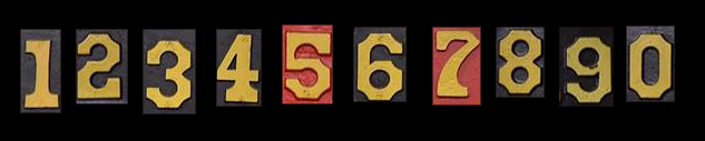

EDIT>> Being handy with photoshop... I may just end up doing it myself. I'll share the drawings if I do. The font itself is incredibly simple. Largely 45 degree letters, with the edges rounded by a consistent radius. The bottom of the 1, the holes and top bevels of the 2. Hard to tell about the "outside" of the 3. The 4 is is a weird one, along with the 5 with a non-standard radius on the inside top. 6,9 and 0 look straight forward, but the 7 is definitely the oddball. The outside curve definitely looks like some sort of french curve. Anyway... I'll stop obsessing. :)

My guess is that it wasn't a defined "font" like we're used to now.
When those plates were first cast, everything was done by hand.
And just like old signs all being hand painted meant they didn't use "fonts" the way we think of them today, older stuff like this is the same way.
I'm assuming they had a collection of number inserts that they would put into the molds and just cast away. I'm also guessing those number inserts were probably hand carved. It wouldn't surprise me if you notice subtle differences as time went on as new ones had to be made.

Joe - you’re on the right track. PRR had their own standard lettering set designs. I have scans of some of those drawings and may have the correct number set - I’ll take a look and let you know.
Lee is correct on the “font” terminology. However, I think of typefaces as lettering sets used in printing. Railroad engineering departments just called the drawings “lettering” or “numbers”.

Ed - one thing I’ve learned from drawing tons of lettering is that although the engineering drawing depicts what it’s supposed to look like, what gets made in the shop for casting molds or paint stencils will mostly-kinda-sorta be close to the drawing. Lots of variation if you look closely. Example: I have at least 13 variations of the “standard” P&WV monogram.

Joe - the tracing number you’re looking for would be correct for the keystone casting. I have a photo of the keystone casting tracing C-89623, Rev. D, 6/11/42 that specs D-25169 for the numbers. I have yet to dig in my archives to see if I have that tracing. I’ll keep you posted.

Joe - Sorry, I don't have that drawing. If you draw these, do note that all are the same height and all but the "1" are the same width. That's why the "4" and "7" look kinda squished. I suspect that the pattern for the "1" may be the same width, though. I can scale the general dimensions off of the number plate drawings if you need them - they do have "sample" numbers on them. However, if you're going to make patterns to cast these, you'll need to get your hands on a copy of the D-25169 drawing.
