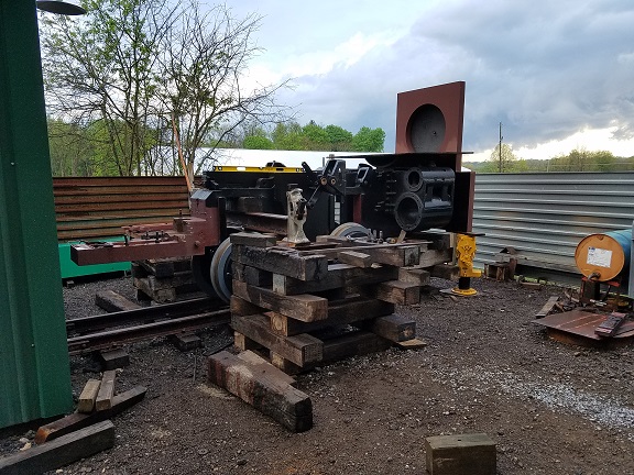

We installed the drivers the old fashioned way, with jacks and cribbing. It took two days to carefully jack up the frame, roll the drivers underneath then lower it back down. Everything went fine with no hiccups.

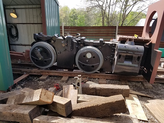

Without the heavy plate rear platform the locomotive is just a tad front heavy. That new platform will be next on the agenda to install. The center of gravity is exactly over the front axle. I can pick up the rear of the locomotive with one hand.

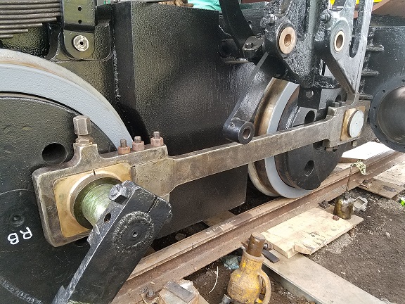

We got the right side rod put on before calling it a day.

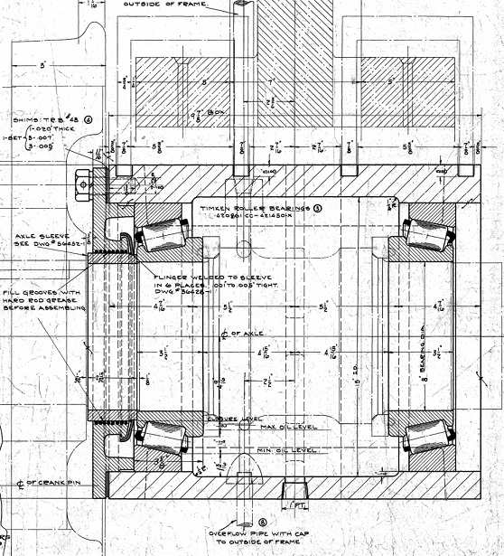

Dave wrote:
The benefit of roller bearings......
Yah, but I do not think that the #58 has roller bearings.
Comments? Am I correct?
 Post subject: Re: J&L 58 is Re-Wheeled
PostPosted: Sun Apr 30, 2017 7:57 pm
It sure does. Big Timken tapered rollers with 8" ID. The boxes were disassembled, bearings removed, cleaned and reinstalled. When we got the locomotive the wheels were locked up tight. That was caused by the seals being rusted, not the bearings.
