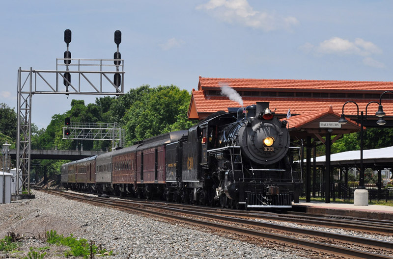

Not only were diesels missing from the steam trips this past weekend (hallelujah!) but something else was also missing. I was really surprised to see an almost complete lack of smoke from the 630's stack. I have never witnessed a hand fired coal-burning locomotive with practically no smoke.
How is this coal treated so that smoke production is so minimized? What is happening in the firebox over conventional coal consumption? Where is it purchased? How much more does it cost compared to conventional coal? How long has it been available?
I'm sure some on this board can enlighten me. I've included a photo taken on Saturday and of course, no smoke.

Your right! That is a clean stack. I used to run steam locomotives at a nearby amusement park which were oil fired and I could never get my stack that clean. I bet G. Mark Ray has the answer.

Proper firing and good less-smoke coal.
This is good for the neighbors around the museum. Personally, I thought the smoky stuff fired a little better, but I like this stuff too. We've used this several times over the last couple years so many recent pictures, at least with 610 are similar. I found that you really have to over fire to get this stuff smoking above a slight haze, whereas the stuff we had been using for the past year generally carried a mild haze with a good even fire.
