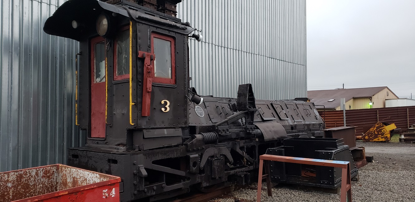

huletteer wrote:
One, No. 3, was given to the Pennsylvania Railway Museum in Strasburg, PA, who in turn gave it to the Steel Heritage Museum in Youngstown.
Built by Baldwin/Westinghouse, they were powered by 250 volts DC, from third and fourth rails between the outer rails, protected by a running board
Here's #3 at the Steel Heritage Museum in Youngstown on November 9, 2018:
