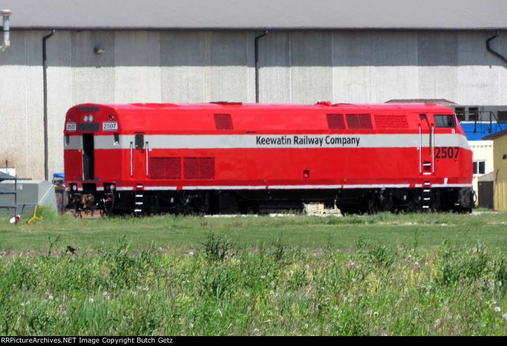

Well, I'll be, I figured someone would give it a try, but assumed it would be an established operation that knows the challenges with those units. I hope those guys know what they're in for all the way up there.
They apparently were worked on at the Wabtec shop in Albia IA, earlier this year, Butch Getz photo there (click to expand).
