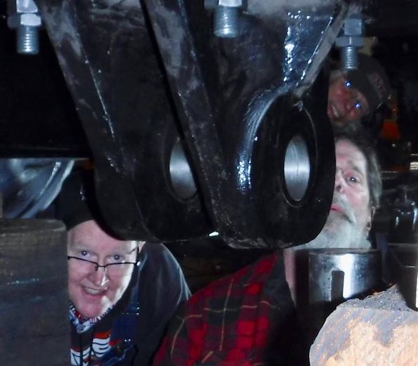

Can you bore the hole just enough to clean it up but dialed in on the current hole, then make an oversized bushing with a new hole off center in the bushing but located in the correct place to give the proper spacing on the finished part? That's what we had to do on the fulcrum for the equalizer for the lead truck. If you look closely at the photo of the rebuilt part you can see the edge of the bushing and that the hole is well below center. I think some spring hangers got the same treatment.
I was thinking this might be less intrusive and the amount of work vs using off the shelf bushings might balance out. We don't have a very good setup for heat treating them. I still need to find a way to resolve the wear on the faces. Someone welded these in the past.

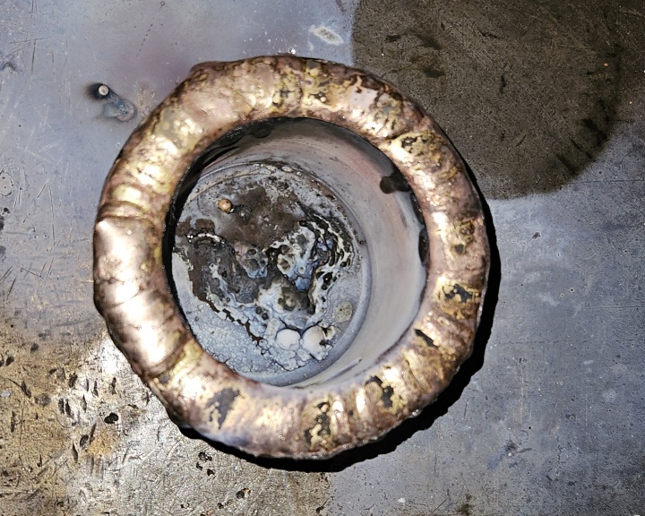

Yes bronze on bronze does not make for a good wearing surface. Cast iron is really the only reliable metal to wear on itself. We are doing some gears in a similar manner. The small gear is getting 309 stainless and the large gear silicon bronze. The only difference being it is applied with mig.
It is really hard to say not knowing what the original filler was. I have found with contaminated aluminum castings the first pass is usually dirty. Grinding it off and the next will be good.
This is an axle thrust collar I did with a torch. It will be machined and wear against a cast wheel hub.
