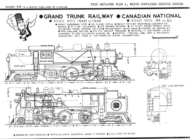

CNR 47, an example of the X10t
4-6-4 tank locomotive, originally constructed to pull light commuter trains without turning. Reportedly an easy steamer, economical to run, capable of pulling several loaded passenger cars.
Three remain in existence, two potentially available for reconstruction.
