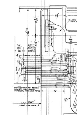

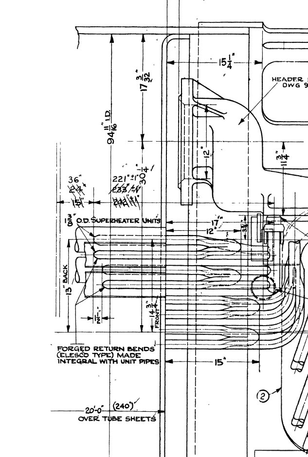

UP Class 4-6-6-4-4&5 had their superheaters shortened 9" as soon as they hit the property in 1943. Shortened again in 1950 by another 12".

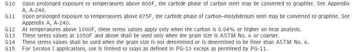

Paul Boschan wrote:
The ASME Boiler and Pressure Vessel Code, Section I "Rules for Construction of Power Boilers", 2023 Edition lists the following tube materials for Section I construction:
• SA-178, Electric resistance welded carbon steel and carbon-manganese steel boiler and superheater tubes.
• SA-192, Seamless carbon steel boiler tubes for high pressure service.
• SA-209, Seamless carbon-molybdenum alloy steel boiler and superheater tubes.
• SA-210, Seamless medium-carbon steel boiler and superheater tubes.
• SA-213, Seamless ferritic and austenitic alloy steel boiler, superheater, and heat exchanger tubes (ferritic only).
Of these materials, the ones most likely found in stock will be SA-178, SA-192, SA-210, and SA-213. The most common ferritic grades of SA-213 are T-11 (1-1/4% Chrome), T22 (2-1/4% Chrome), and T5 (5% Chrome).
Stress tables Section II Part D:
Footnotes indicate alloying elements to prevent decarburisation at higher temperature operation.
Note: G10 is for SA-192 carbon steel tube.

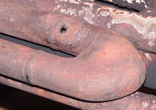

"Old" Elesco return bends were forged from two tubes. These days the return bends are cast and then welded on. Even if the material is adequate you have the variables of casting quality and attachment welding quality. This photo shows a pinhole failure due to botched weld. Welds have to have a nearly perfect root profile on the steam side to eliminate steam erosion due to globs hanging into the steam flow. Most powerplant superheater welds are 100% x-rayed to eliminate this type of failure.
