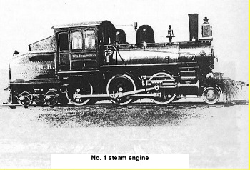

Hi all
I am trying to do a complete Steam Locomotive roster on the Shortline of the Grafton & Upton RR,, located here in Massachusetts.
The roster is for my own records,, so far but I am stumped on one photo, that I will post...
The locomotive was the 3rd Grafton & Upton # 1 known as the
W.N. Knowlton...
Note the wheel arrangement a 2-6-4T
Because I could not find no information on the locomotive background I don't know who built it,,,,Baldwin???? or American Locomotive works,,???
The only information I have it was built in 1893 for the Grafton & Upton RR...
The boiler jacket looks to be a different color from the rest of the engine.
So I am asking the experts Who Build it????? Thank you as always Pat.

Grafton & Upton Railroad #1 "WM. Knowlton" 2-6-4C
Rhode Island Locomotive Works
Built: July, 1893
S/N: 2931

I see the answer was posted. However....
Most of the Baldwin Locomotive Works engine specifications records, 1869-1938, are available online through the SMU library. You can check there for that manufacturer.
Bart

Hi
Thank you alcoguy1 it is appreciated for you knowing the answer to my question,, again Thanks , Pat.
