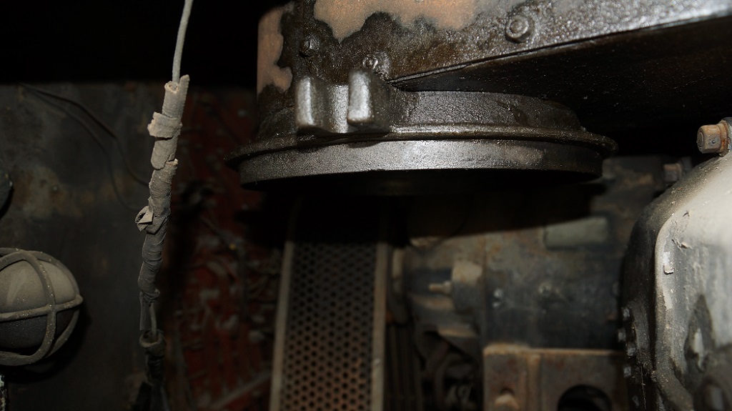

Sorry, I forgot the photo of the location for the part in question.
Gary Rodriguez
SA, TX
File comment: Photo of the location of the missing filter canister(?).

Original circular blower mounted filter was usually 8050846.

Catalog 301, List A378. I doubt EMD has any, it would be a scrap/salvage item now.
An SW1 uses one filter, an NW2 uses two of them. Farr marketed a rectangular replacement unit many years ago. If you want to adapt a currently produced air filter a 6-567 engine requires about 1800 CFM air flow.

I'd suggest doing a little shopping for the adapter to run a Clark "small baggie" filter. I can't remember if that's the EG-1 or EG-2 part number. Both our SW-1s have them. Fairly common and available in an extended life version as well.

I scrapped/parted out an EMD SW9 that had an air filter that used a round long heavy equipment filter you could just purchase at any Napa store.
The SW9 had 2 of these.
A lot of the older locomotives originally used an oil bath filter.
