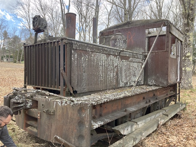

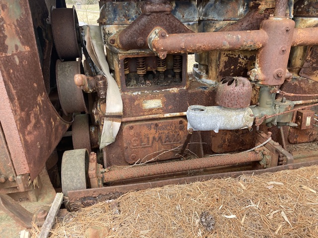

Hello people,
I recently had the opportunity to inspect two of these lovely beasts. Both date back to 1926. My question is where would the serial numbers be located - if in fact it survived?
This and two other identical Plymouths were used on the Madawaska Company’s Eagle Lake & West Branch railroad. Two, were purchased by the Madawaska Company and the third by Great Northern Paper. Two survive. I have serial numbers for all three.
What I would like to do is match the surviving locomotives to the serial numbers on record.
Thank you!

Thanks Bob,
In this case “search” is not my friend. As you can see in the photos I provided in my original post, these are built up frame locomotives rather than cast. The thread you provided the link too indicates that the serial number may not be in the same location as the cast frame models. Another thread indicated that some models have the serial number stamped on a small metal plate riveted to the cab wall. But again, they were a different model and era and might not apply.
My access to the locomotives is limited so I am trying to pin it down as close as possible to preclude a lengthy or invasive search.

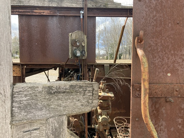

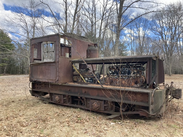

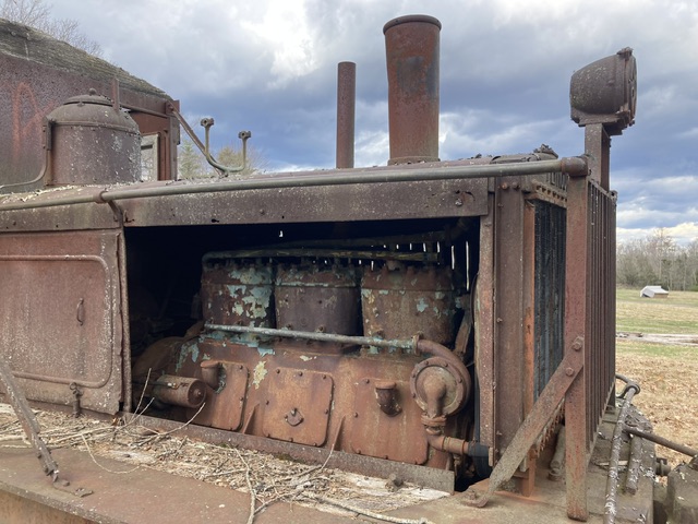

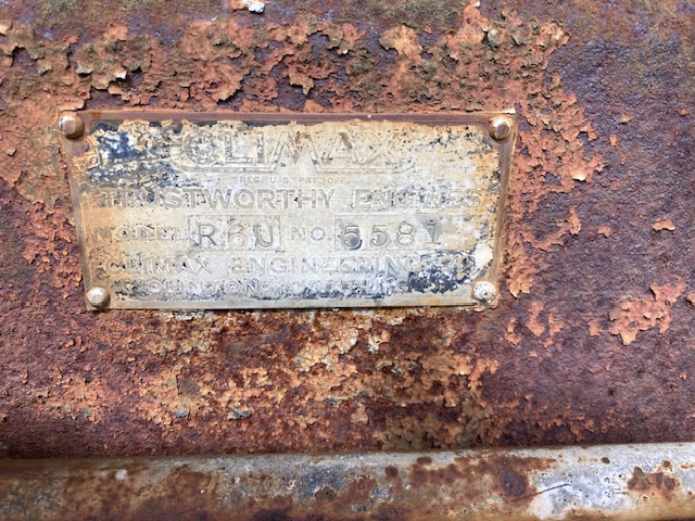

Thank you John & Kevin,
I believe they are the original Climax R6U engines. The one tag I examined is serial No. 5581.
I will check with them. The best part about these particular locomotives is other than the bells and a missing stack and rotted wood work, they appear to be nearly 100 % complete.
