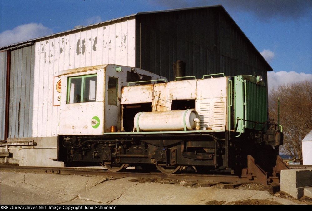

Edit #2: here is what one of these units looks like, John Schumann photo: C/N 4354 http://www.rrpicturearchives.net/showPi ... id=3507717

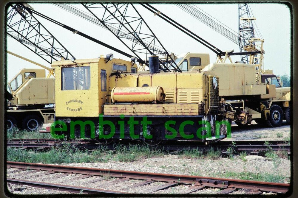

Could be this (does it say "Chipmunk Express" on the cab?): https://www.worthpoint.com/worthopedia/ ... 3759846910

The photo is of our loco.
