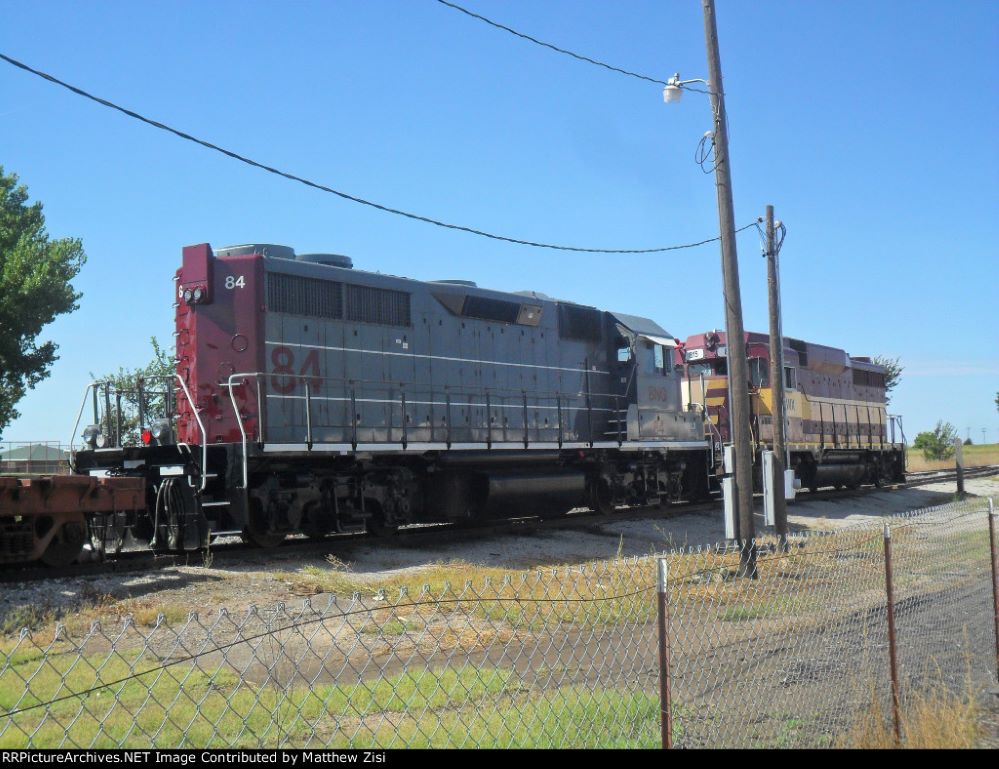

Ex-Santa Fe branch, was part of regional South Kansas and Oklahoma RR after that, 37 miles of excepted track. https://en.wikipedia.org/wiki/Blackwell ... _Railroad#
They have, or had at one time, one ex-Armco Steel GP38-2 leased from Midwest Locomotive Works and one ex-C&NW/WC GP-30 from Everywhere West leasing, but the GP30 had its windows broken out. Matthew Zisi photo.
