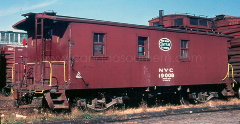

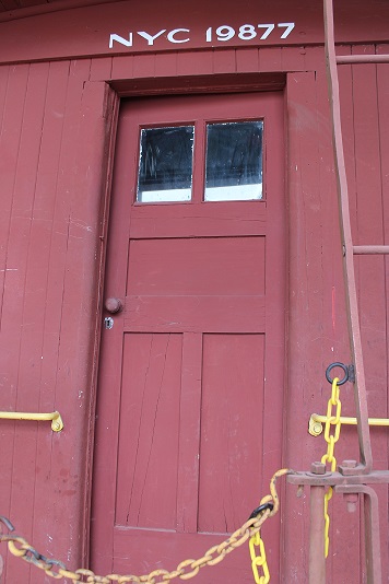

New York Central had cabooses numbered in the 19xxx series (PRR did not), I haven't found a photo of yours (if it is NYC) but here is 19008 (in service) and 19877 (which is at R&GVRRM): https://canadasouthern.com/caso/NYC-MODELS-CABOOSE.htm http://www.rrpicturearchives.net/rsList ... =NYC&cid=1
Edit, from R&GVRRM website: "Built in 1921 by the New York Central’s own shops in Oswego, N.Y., this cupola caboose has a steel frame and a wood body. Part of a group of 115 cars numbered 19001 through 20082 (Lots 427, 468) constructed at Oswego Shops between 1912 and 1923, these wood body cars made up the backbone of the caboose fleet through the 1960s. The original construction cost of No. 19877 was estimated to be about $3600.00. The car is 36 feet in length and features a truss rod underbody design." https://www.rgvrrm.org/about/railroad/nyc19877/
Not positive it is a NYC caboose, but it is a good guess.

Thank you for that information. In looking at the second picture, the door panel and window pane construction as well as the door handle location in that photo match our door perfectly. This is great news because none of the other RR Historical Societies' which I have inquired at have had caboose door constructions that match mine yet. Your photo is the first one that matches ours so maybe we are on the right track, no pun intended.

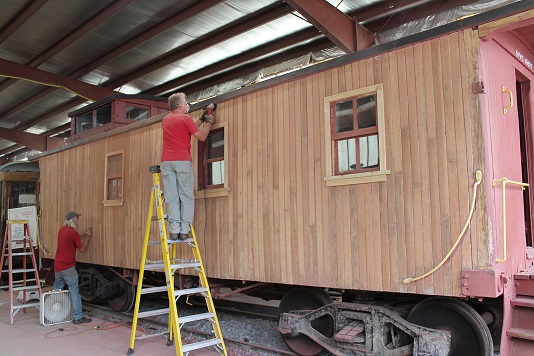

Some shots of the NYC 19877 from today, at the RGVRRM, near Rochester NY.

File comment: The sides of the car have been stripped to bare wood for repainting, and nearly all of the windows have been replaced with new. This will be (at least) the third major restoration of the car, since it arrived at the Museum in 1987. Wooden cars and Western New York weather are not a good combination!
File comment: Bernie Beikirch on the left, did most of the paint stripping, and Charlie Marks on the right, has built and installed the new windows.

Thanks for the pictures John. That door construction is identical to ours right down to and including the skeleton key escutcheon plate. I think we have confirmed proof that I have a NYC door. Many thanks to EVERYONE who has has graciously shared your expertise.
