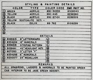

I have this chart from EMD Styling & Painting Diagram ## 8446040 dated 4-14-70.,
That diagram is for Ashley, Drew & Northern 150, an SW1500 that the AD&N purchased new from EMD.
I’ve looked through all the references that I can find and cannot locate the numbers for the Yellow and Green that are in this chart. So that I can cross reference them.
If you look on this Condren Rails page and scroll down to the third picture from the bottom, you will find a picture of AD&N 150 in this scheme on October 26, 1975.
https://condrenrails.com/AD&N/index.html
Any help would be appreciated.
Thanks,
Tad
 Post subject: Re: Railroad Color Library
PostPosted: Mon May 24, 2021 9:26 am
Posts: 1947
Tad - let me check on these for a cross, though I don’t think I have them. Your “Refer.” column is the DuPont product and color numbers. The EMD column is the color in the styling book which will reference back to the DuPont number. Sadly, the DuPont numbers are no longer valid and can’t be crossed to current formulations. I’ll do a little digging and see if I come up with anything. For future reference, I’ll add these to the list in case something pops up later.

I've exhausted all my sources for cross references and can't find any references to the DuPont 34559 green and 445 yellow. I don't have access to any EMD swatches so I can't look for a cross there though they'd likely point back to DuPont.

In looking back through my stuff again, I found that I also have EMD Styling & Painting diagram # 8336318 for AD&N 178 dated June 12, 1963.
The chart from that drawing looks like this:
The DuPont color codes are the same, but the prefix is different. The EMD numbers are also different. That may just be a 7 year thing.
AD&N 178 is the other unit in the Mike Condren photo referenced above.
I guess from “eyeballing” that I am probably going to go with Reefer Yellow and CNW Green.

Yeah, I’ve yet to decipher all the different DuPont prefixes over the years. I know the 939s are acrylics of some sort but the 890s were Lucite. Maybe someday I’ll run into an ex-DuPont coatings guy that can explain all the prefixes.
