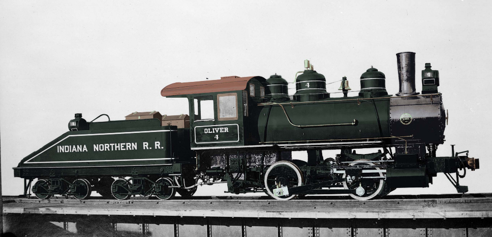

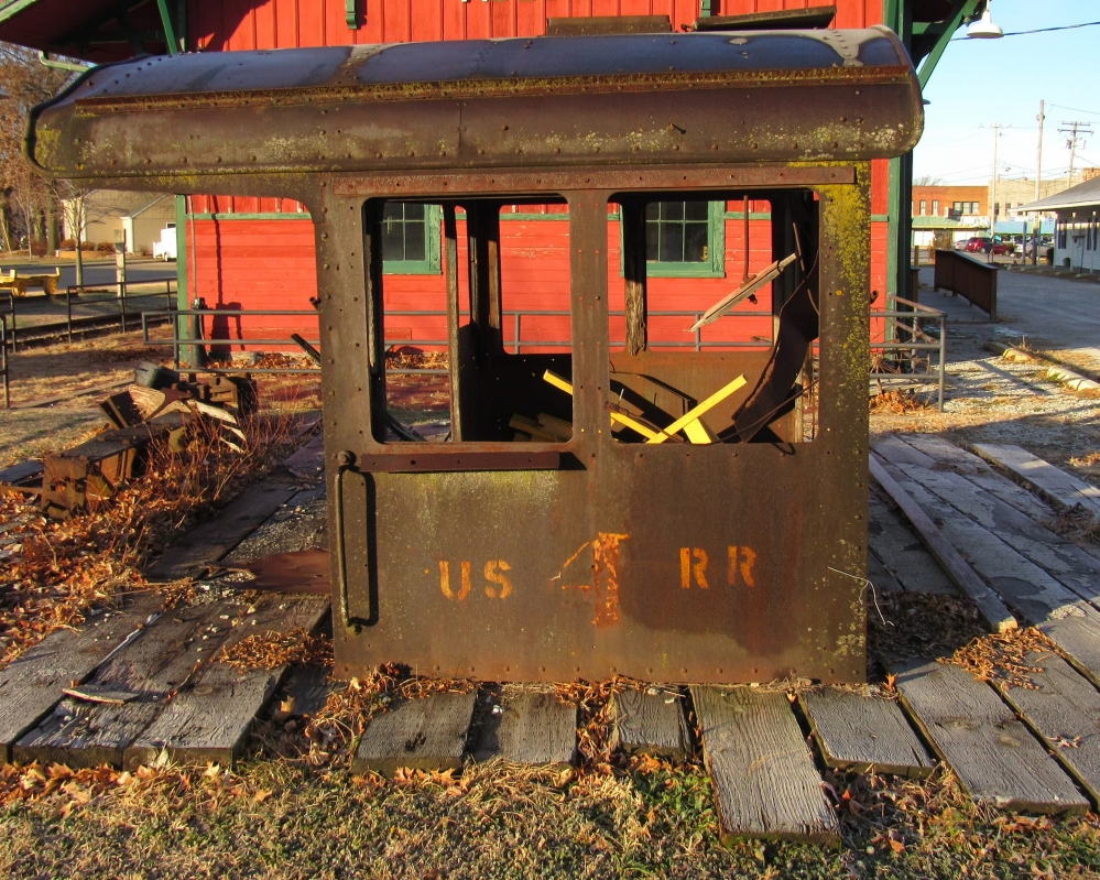

The cab will be a very visible component of the engine which we will use to show our progress and give insight to how #4 will appear once returned to operation, backdated to its 1913 as built appearance in olive green and aluminum (Baldwin paint style 363). The work necessary for the cab, while extensive, is not unmanageable or uncommon for most locomotives. Only a minor amount of metalwork has been identified- replacement of the rain gutters on the cab roof, patching small sections of the bottom of the rear cab wall, and replacing the angle iron brackets at the cab floor that allow the cab to be bolted down. From there the cab can be media blasted to bare metal and painted with primer, the wood lining remade with new lumber, and then it can be painted over in the appropriate shade of Baldwin green. When we’re done the cab will look just as fresh and green as it did when #4 left Baldwin nearly 110 years ago!
File comment: I.N. #4's cab in Aledo, shortly before being moved to AIRS' storage and work site.
