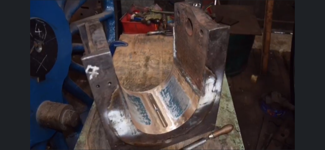

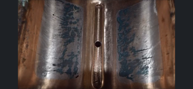

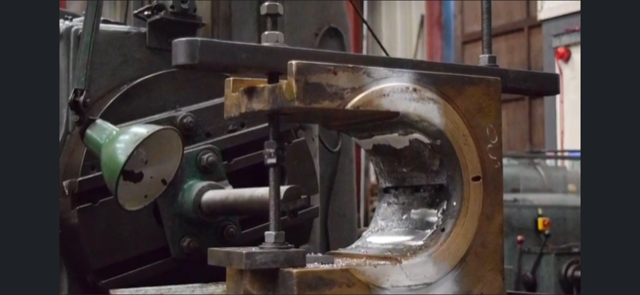

I was looking at a status update from the Railway Preservation Society of Ireland on the return of a 4-4-0 to service and noticed that their axle boxes are of the same design Steven started the thread with.
https://www.facebook.com/steamtrainsire ... 1481751116
It seems that the bronze surrounding the white metal is intentionally part of the running surface and that the white metal doesn't sit proud. Seeing as this is in contradiction to what Kelly & J. David mentioned, would it be safe to assume that European practice is just its own animal and that the Chinese practice is very close, but no cigar?

Greetings:
Kelly, the Chinese thought of that issue. The oil cellars on Chinese steam locomotives have plates welded in about 1/4" from the ends where the axle goes through. Foam rubber is fitted into the slots created up to the bottom of the axle forming dust guards. These have been renewed once on 3025 since the locomotive began running at the Valley in 2011.
In response to stewi10, et al, Kelly is correct: on 3025 the Babbitt in the crown brass pockets sits proud of the bronze. In ca. 2018, a feed on a 4 way divider feeding the crown brass on the left main driver got plugged and the axle ran hot on a Saturday and was reported by the Engineer on the work report. Whoever the Mechanic on Duty was the next day wrote: "Noted" on the report without determining what the problem was. On Sunday the axle got hot enough to melt the Babbitt. They had a dickens of a time digging the melted Babbitt out of the oil hole, but they did, and polished the axle and repaired the 4 way divider. I wanted to drop the wheel and sent the driving box to Strasburg Rail Road to be rebabitted but were in the middle of the operating season, and, and, and. So we didn't. It has been fine ever since running steel on bronze, generally 5+/- degrees warmer than the rest of the driving axles.
However, even though the Babbitt is no longer proud of the bronze, the rest of it is still in there. I wonder if that is enough to keep the axle running cool or is it simply that it is oil lubricated. I was once told that the reason for the Babbitt was because as the axel turns a microscopic amount of Babbitt wears away and is carried with the oil to lubricate the axle. I would be interested to learn the thought process of the Southern Pacific in their decision have Babbitt pockets in the crown brasses of their large road locomotives such as 4449 and what the experience of the 4449 crew has been over the years.
