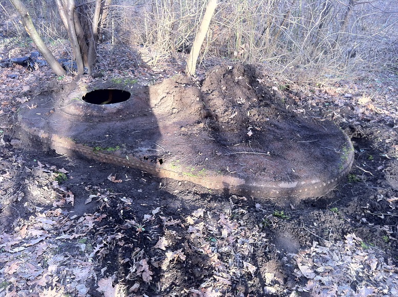

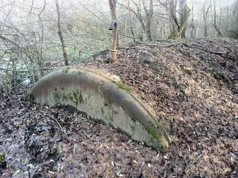

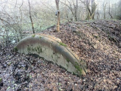

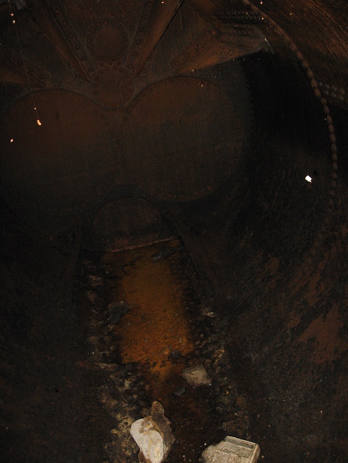

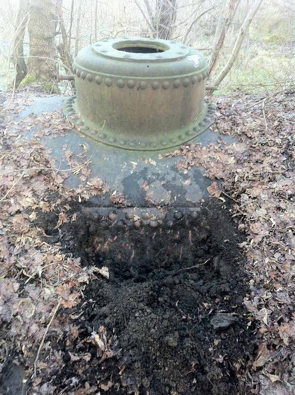

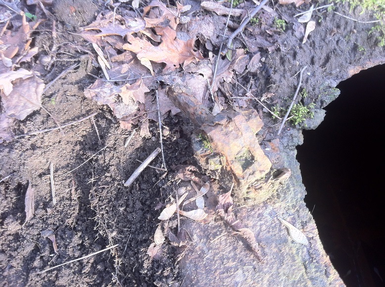

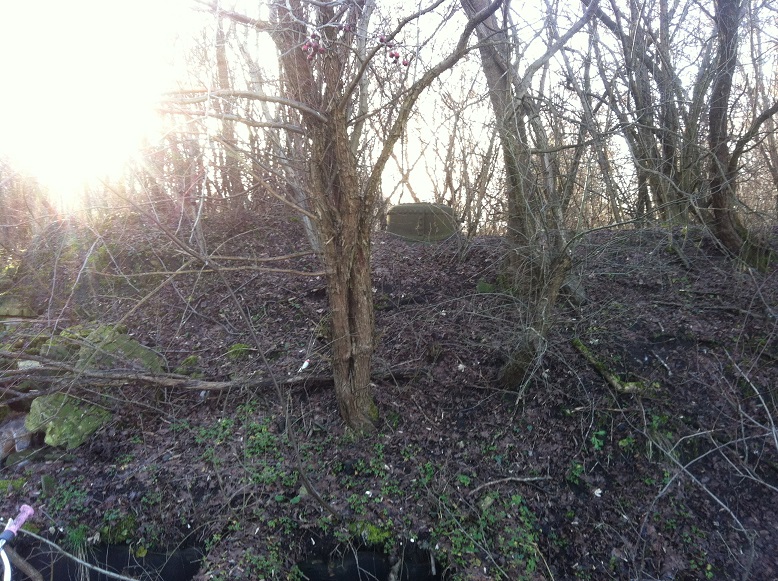

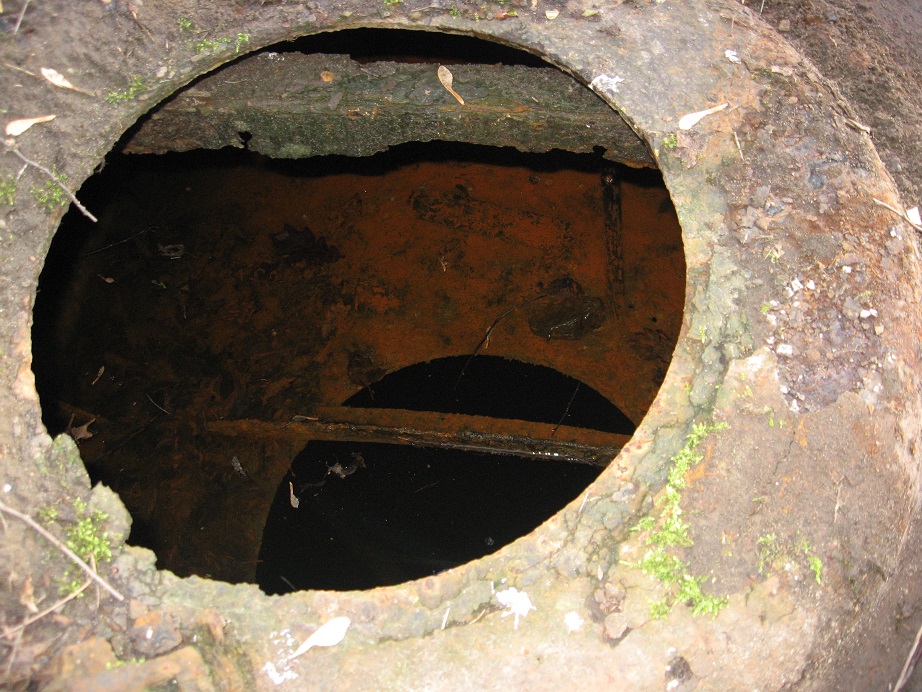

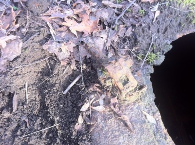

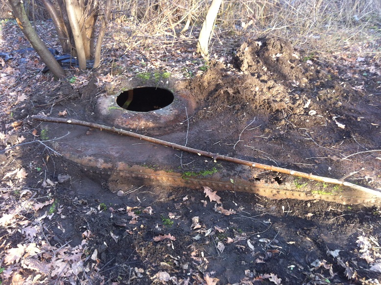

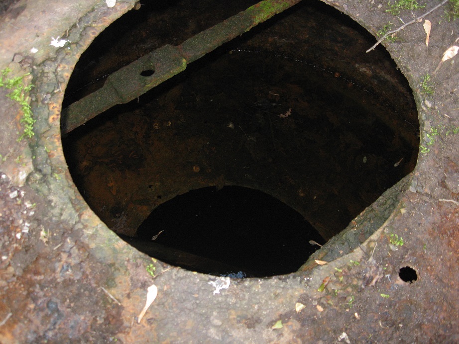

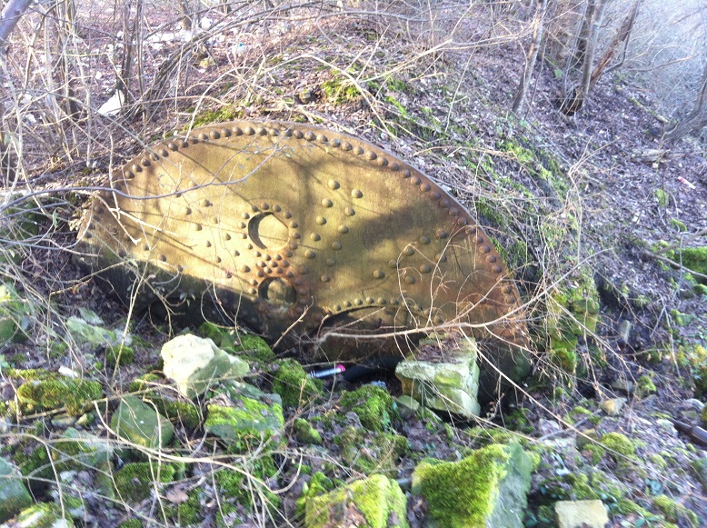

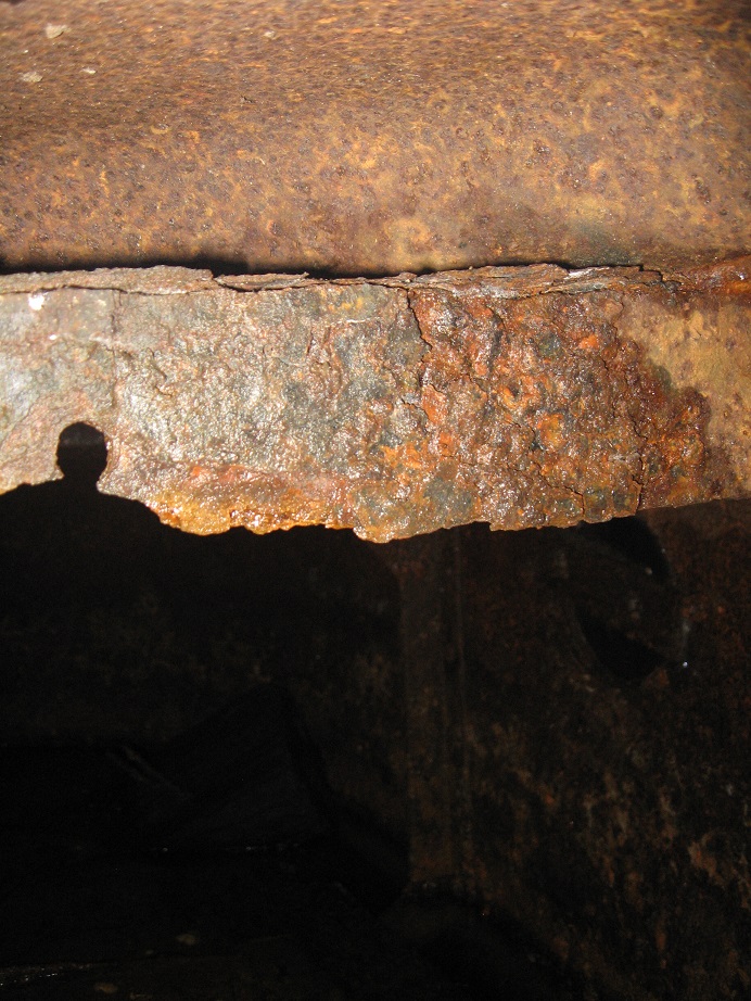

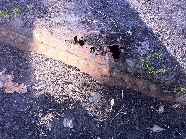

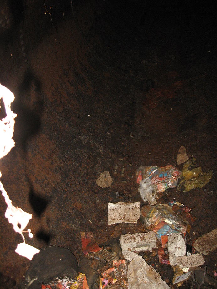

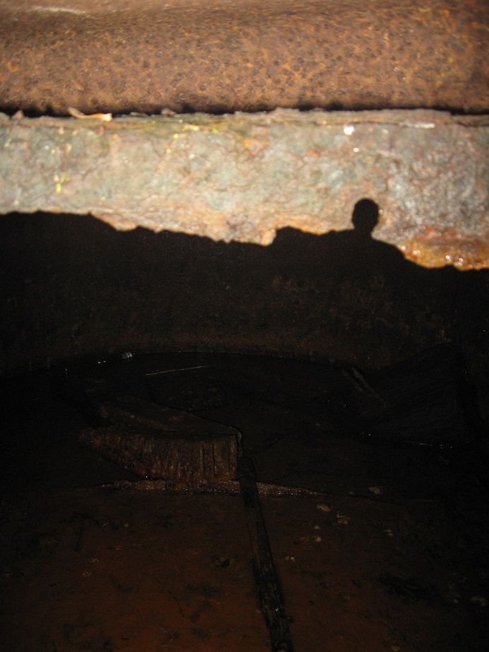

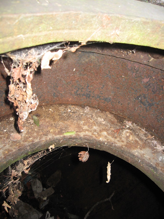

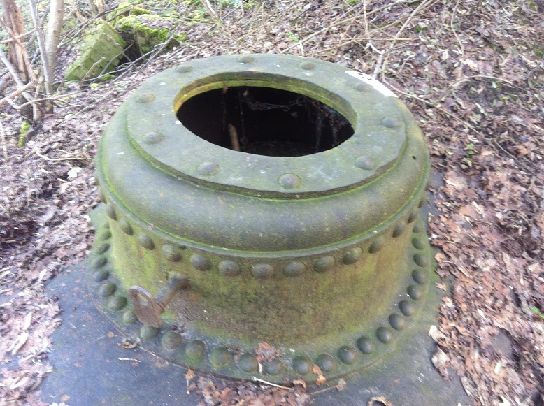

I was exploring an abandoned narrow gauge yard recently and discovered these two "tanks". The documents I have seen say that this was used for fuel storage, however, these vessels are clearly too complex to be "just tanks" and surely must have been repurposed from something, somewhere.
Can anyone recognize what these might have been?

Kelly Anderson wrote:
That is a Lancashire boiler. Interesting to see one outside of Great Britain.
Some photos are on Google
Thanks!

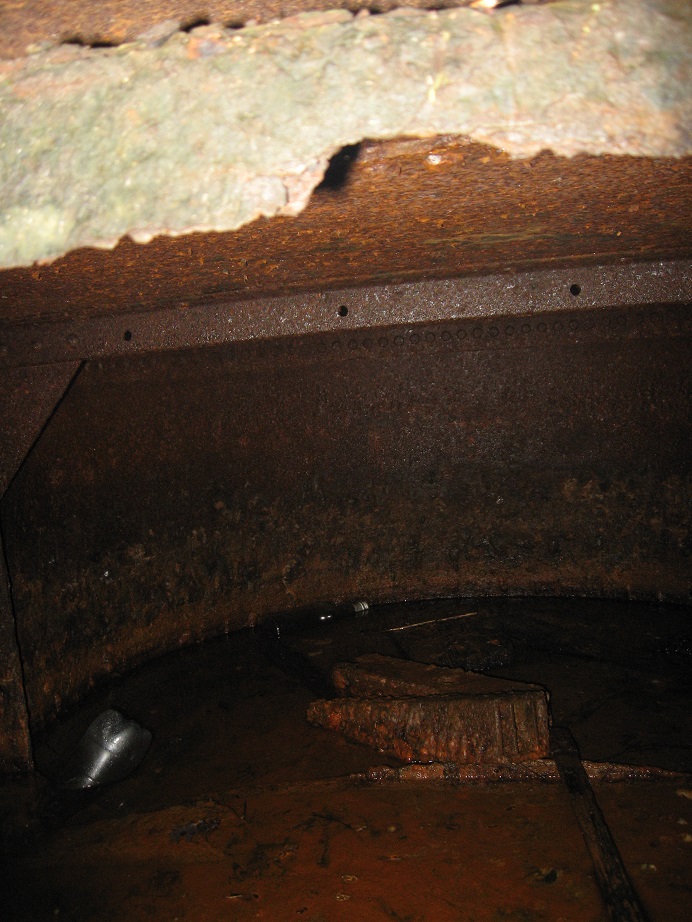

I'm trying to add photos of this second vessel, but I keep getting the message
"Sorry, the board attachment quota has been reached."
What's that all about?
At any rate, I also have photos here:
http://750mm.pl/index.php?topic=2425.msg86171#msg86171
As you'll see, it has some baffles inside. I used a tree limb as a dipstick to try and figure out how deep it is. The water line is where the stub of a branch is.
 Post subject: Re: Repurposed Pressure Vessel Recognition
PostPosted: Tue Jan 17, 2023 8:15 am
Posts: 231
From the looks of the interior shot... I'd say they were used as cisterns. No trace of petroleum residue.
PostPosted: Tue Jan 17, 2023 8:38 am
Posts: 1116
Location: Warszawa, Polska
But I could definitely smell something along the lines of diesel fuel in there.

Scroll through the photos of the Steamboat Arabia Museum and you will see the 3 Lancashire Boilers. https://www.google.com/search?gs_ssp=eJ ... VDMWZMX2dH

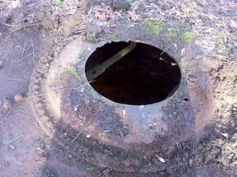

Here's the other vessel I found. As you can see, it has some internal baffle structure. I used a tree limb to see how deep it runs, and you can see the water line (where the stub of a branch is).

Any thoughts on what this second vessel might be?
